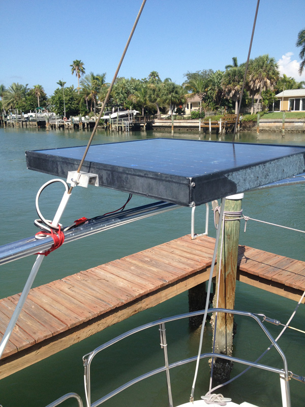

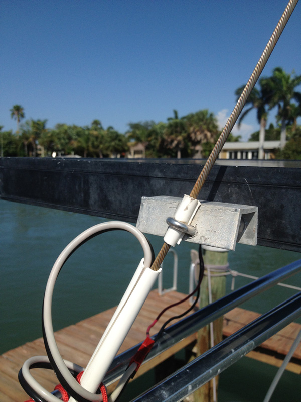

Im in this same dilemma with my '87 302. Im thinking arch with integrated bimini. I can't commit to a hardtop, because I like to be able to put the bimini away in nice weather. I currently have a small (30w) panel mounted between the split in my backstays, but I NEED MORE POWER.

Hey thanks for the reply and pointers. I'd be curious to see how you've mounted the panel between the backtay split. Have any pics to post (you can e-mail me direct at jonboffa@hotmail.com if that's easier...)?

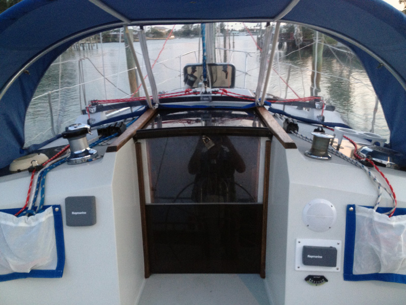

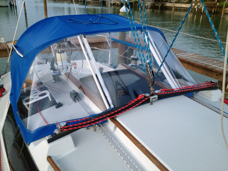

I've attached pics of the panel as well as a couple of the cockpit so you can compare some mods. Post up pics of yours when you can.

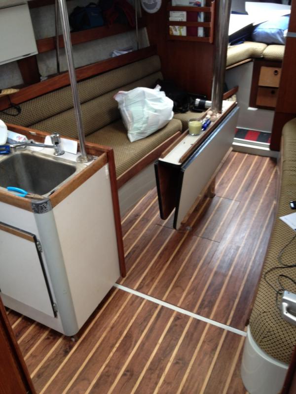

Just redid the sole on my 302. Used adhesive vinyl planking from lowes cut down to have somewhat of a teak and holly look. Total cost: $49. The stuff is very easy to cut, I just used a straight edge and scoring tool, then snap.

Alpine, your floor looks great, did you find a vinyl plank in teak and holly at lowes?
Jul 12, 2011
148
Oday 302 st pete
No teak and holly panels. The dark parts are 6" x 48" vinyl planks that I split down the middle to 3" x 48". The lighter strips were originally 4" x 36" that I split into 1/2 inch strips.
Here's a link: vinyl planks.

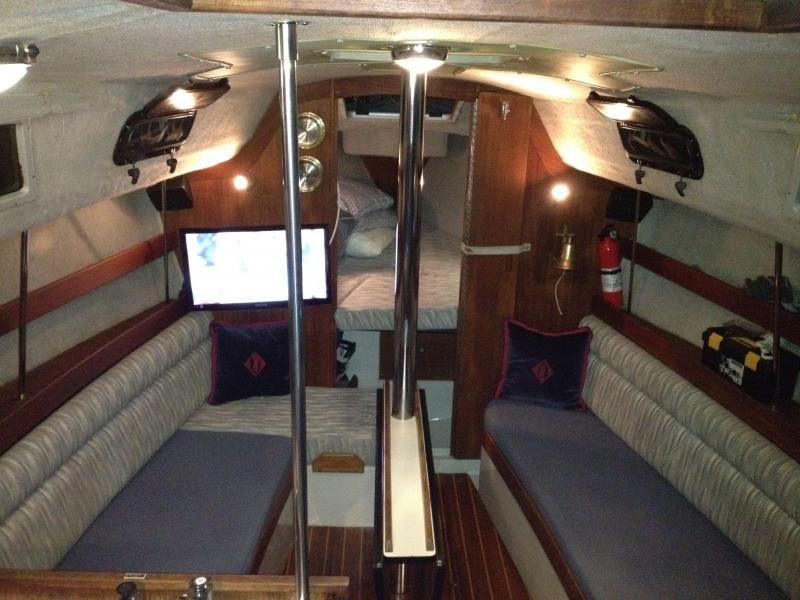

Not much has happened since I purchased my 302 about a month or so ago, but my kids insisted I install the TV and DVD/Blu-Ray player for our overnights.
