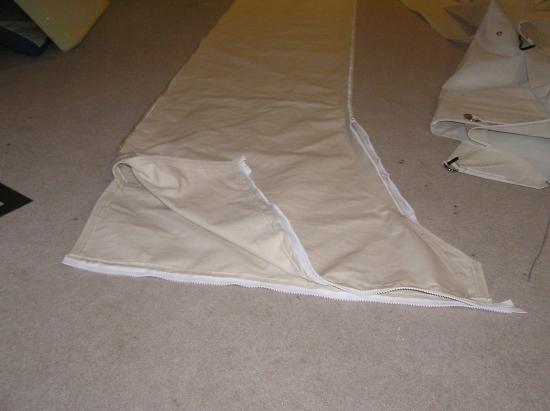

I just finished sewing a mainsail cover for my new sail. This cover will be used to restrain the sail on outings lasting a couple of weeks, it will not be used to store the sail for a long time. This cover is designed for a loose-footed mainsail. It is designed to fit inside the forthcoming lazy jack setup.I chose cotton canvas because I like its looks and feel and I like its superior breathing. Try pulling some air through Sunbrella or Top Gun. I will finish with some waterproofing spray when it warms up.Not very visible in the picture is a boltrope along the middle bottom of the cover. Since my main is not using the slot on the boom, I will use it to hold the cover in place. The zipper along the top and in front of the mast is a UV protected material, both #10 marine grade.I made the cover with some extra material, and it will fit over the boom and the sail if I so desire. This way I can slide the cover into the boom slot under the loose footed main, raise the lazy jacks, drop the halyard, and zip up the cover, knowing that the sail is safe and protected and won't inflate if a blow comes along...John S Boise
