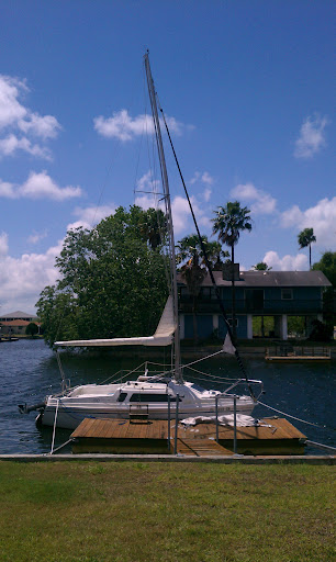

I just bought a 1994 Hunter 19. At least I THINK I did. The registration says "custom" under builder and has FLZ as the manufacturer in the HIN. The full HIN is FLZW7219B894. It is titled as a 1994, but is more consistent with a 1988 according to my Google searches. It has a fixed keel and fake side windows. I am not too concerned with this but just curious. What I am concerned with is the mast. As you can see in the pics it is really bent back. I got this boat for $600 and it included a nice Mariner 8.0 kicker. All of the hardware/lines/rigging is in excellent shape and the rest of the boat looks very clean.Any suggestions as to what the "custom" means or what to do with the mast? Also for what its worth, the boat came with a Hunter Water Ballast Series Owners manual.

wow! It looks like a 19, but the mast should be straight! it looks like it's got a forestay that's way too long-maybe someone tried to adapt a jib from another boat?
you need to get the mast straight and properly set up. if it's a water ballast 19 it will have a centerboard, lowered and raised with a tackle. there should be a valve control for the water tank just inside the companionway.
LOL, I was thinking a straight mast is probably a good thing. I will bring it home as soon as I get a trailer. It will be interesting to see what it takes to get the mast right.

Thank you Dave. Everything checks out 1994 as far as I can tell. What has me confused is the side windows are fake, just paint and the HIN as you stated. The FLZ is a florida custom built and the registration states Custom as maker. Florida has salvage titles for rebuilds to the best of my knowledge. I am not too concerned as the boat is very clean and everything is there. All Harken hardware, new lines and even a nice 1994 Mariner outboard.From all of my research Dave, you seem to be well versed in masts. Whats up with my banana looking mast? I spoke to a Hunter dealer and he said some came with wildly bent masts.....

It could have also been a boat acquired with no title and the buyer sought and was able to obtain a homemade title. Would not be the first time. As far as the mast, you just have an excessive amount of rake. Check the tension on the fore and backstays. Don't know about the windows, could have been a special order. Look for the HUN # stamped on the hull. They are usually stamped in the upper starboard transom. If it has been erased or altered you may have your answer.

well that could be your "custom" boat , Ive never seen one that small with a main furler in it. if it works then yes thats a plus indeed. the fact that the jib is furled and the main means you'll have a care free sail in most any conditions. the main can be reefed with the furler in the event of high winds as well as the jib. nice looking boat ya got there.

Looking at the photo again, what you see is probably hull 000000 or prototype and that would answer the Hull ID. As for the mainsail, that gentlemen is an expensive what appears to be a boom furler and if that is the case, that is a very nice option as you can reef the mainsail to any degree.
