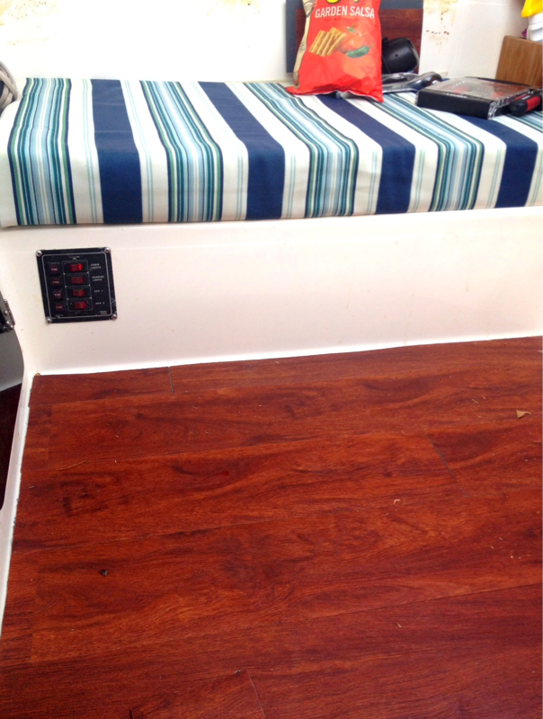

I started to, and will likely finish the project that way. I think a good coat of shelack is in order. Below is the prototype
