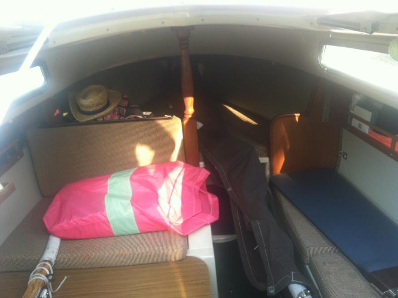

In our boat the cushions are mirror images. If you have the starboard side I assume you could use it as a pattern for the port side? I would not be difficult to make it yourself or you could take your starboard cushion to a local upholstery shop and ask for them to make a mirror image of it. However, if they are different the upholstery shop would have to measure the area inside your boat.
When we bought our "new to us" 1982 Catalina 22 and later upgraded to a 1979 O'Day 25 - both had filthy interior cushions. I went to the local fabric store and bought upholstery fabric on clearance then used the existing cushion covers and cushions (when the cover was missing) as templates. The back (where the zipper is) and bottoms of all the cushions were vinyl or a solid color denim fabric that was still in good condition since they were always inside. I reused these fabric pieces to save on fabric, time and installing new zippers. I simply replaced the top, front and sides with the new fabric.
Luckily the foam was in good condition, as it is VERY expensive to purchase since it is a petroleum product. In the middle of the O'Day 25 project my 35 year old sewing machine broke, so I bought an old used Singer off Craigslist for $50 to finish the job. I have sewn for years, but this would be a simple sewing project for anyone.
I did buy sunbrella to make covers for the outside teak trim pieces. The uncovered trim pieces in the photo are new ones we fabricated from "plastic" deck wood in hopes of minimizing our maintenance to maximize sailing time.
I also bought an inexpensive indoor/outdoor carpet from Home Depot and replaced the original hull liner with it. We love our renovated O'Day 25 and camped on it every weekend last summer!

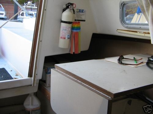

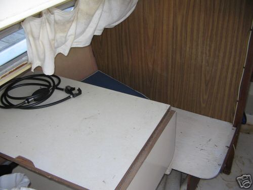

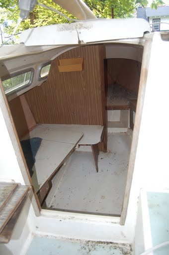

Can draw you a pattern if that will help! My 22' was modified to remove the main cabin "galley" cabinetry and install a pop up table using part of the port bunk as dinette benches.
Jun 2, 2004
1,944
Oday Day Sailer Wareham, MA

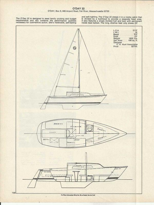

Is your boat a 1972?
If so, she wasn't modified, that was the stock layout originally when the 22 was introduced for 1972. I believe the layout was changed to the more well known design late in the 1972 model year.
Mar 29, 2013
34
Oday 22 East Jordan
Wow! I have never seen any pictures of a '72 (which is indeed what mine is) I can see why they changed the thwartships bench to a cabinet, as that is pretty much wasted space though mince has an enclosure which contains additional flotation material. There are several such boxed in areas like that in various places on the boat.
Thanks so much for the pictures!
