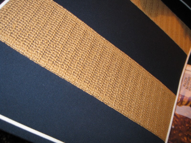

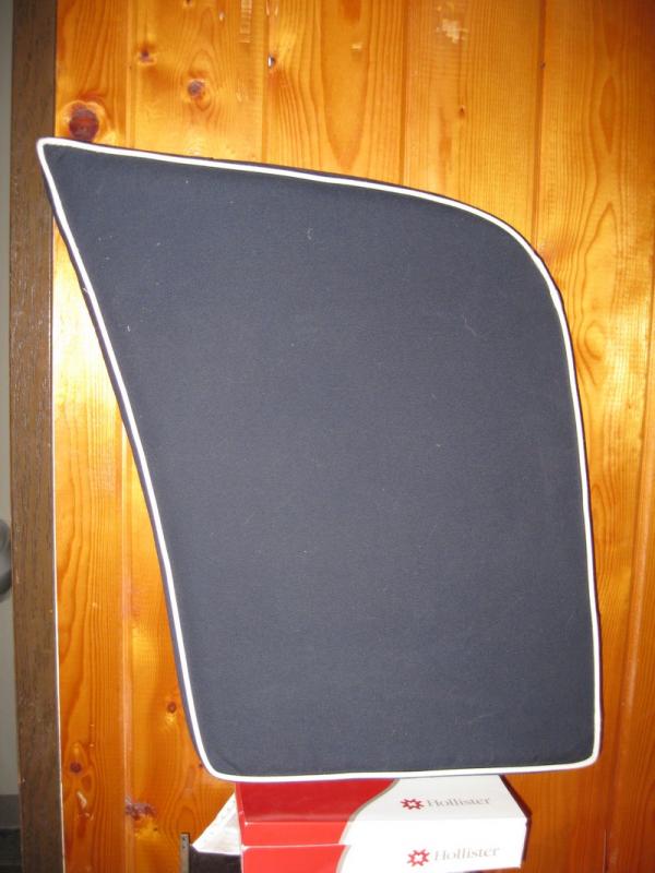

Hi Tammy, here is a shot of the cushion back, grippy rubber material. I had all 5 made for 1200 cdn. The other shot is the rear lazerette cushion, 14 wide at the narrowest, 22 long at the back, and 17 long on the front to the start of the radius turn.
The cushion material is expensive, as is the curved 5th section.
