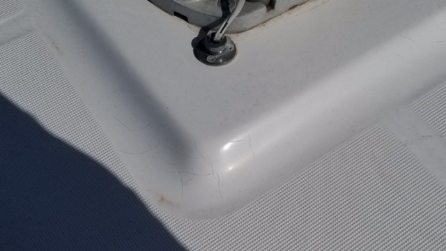

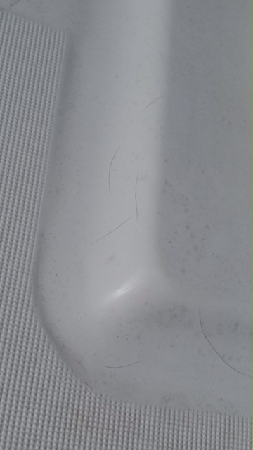

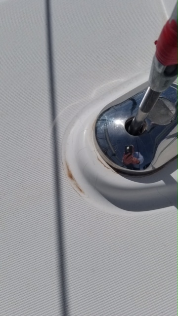

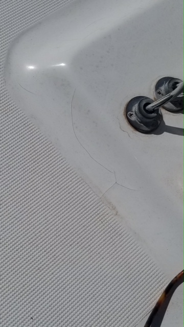

I have appreciated the responses so far, and investigated products such as MajicEzy, and Interlux Perfect.

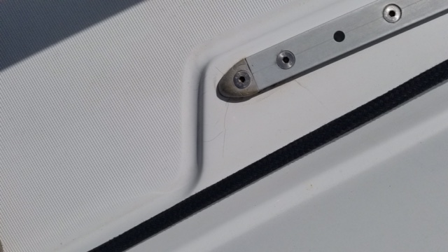

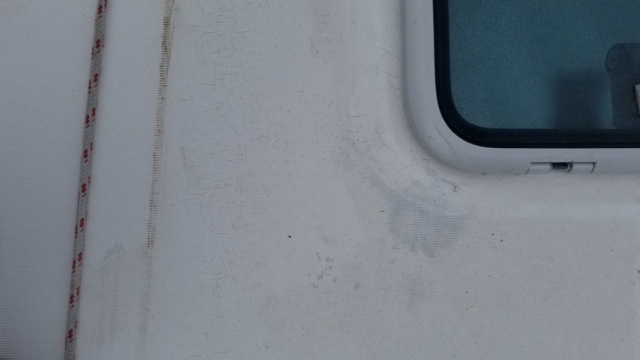

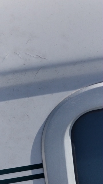

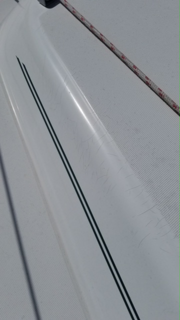

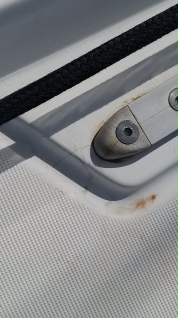

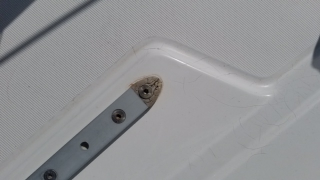

I have to say that the treatments are tedious and expensive. I am providing some photo examples of the entire deck surface along with affected areas around portlights, toe rails, hatches etc.. perhaps 100 sq ft of affected areas.
12,724
Yes, that is the nature of the repair. My Sabre has numerous gelcoat cracks that I have mostly learned to live with. There are a few that are particularly annoying, so I may try to repair them with flexible epoxy and gelcoat, but they are not high on the priority list.
Most of the cracks you showed are around tight radii. That is a particularly problematic area for gelcoat for a number of reasons. First, when the glass is laid up, it is difficult to get the glass fully into the tight areas, that often leads to voids behind the gelcoat that are not well supported so cracks form. This is an issue with convex corners. Concave corners have their own set of issues, notably there may be a layer or two of glass that does not wrap around the corner, this allows the flat surfaces, the deck and seats to flex a bit which causes the brittle gelcoat to crack. Finally, when when the deck is released from the mold the stress causing some twisting and that causes the gelcoat to crack. These cracks should be fixed by the boat builder, but if it was weak enough to crack when taking it out of the mold, the cracks may reappear.
The quality of the gelcoat and its application also affect crazing. Sabre produced a bunch of 362 that developed extensive crazing. Once they realized they had a problem, they changed gelcoat formulations and the problem for the most part went away. While I am not very familiar with Beneteaus, I would not be surprised to find out they had a similar situation. Gelcoat is very brittle and if it is applied to thick, it will crack.
I think you will be hard pressed to find an older boat without some hairline cracks.
