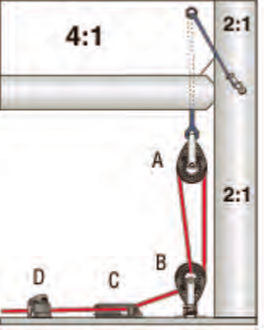

PSR: Guess I'd better read the posts! Sorry, I guess Jackdaw and company explained it quite well on another post. In essence what was said is even though you can draw and tighten with halyard and sheet it is quicker and more effective to use a simple 2to1 Cunningham that runs aft to the cockpit.

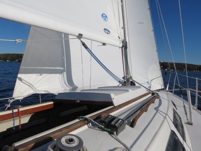

A point of clarification..... downhaul vs. Cunningham. When I was learning to sail, way back when, this was my understanding: The downhaul referred to the "boom downhaul" Where the boom's gooseneck attached to the mast slot with a slide... allowing the boom to move vertically. Many boats were designed with this type of connection... most had attached foot mainsails... so pulling down on the boom actually had an effect on the foot of the sail also. The Cunningham bypasses the boom and works directly on the mainsail luff... while the boom remains statically attached to mast.
When I purchased my C27, it had a boom downhaul system used with an attached foot mainsail. I purchased a new, loose foot mainsail with a Cunningham cringle. So I converted to a Cunningham by fixing the gooseneck statically to the mast with some set screws. I replaced the straight hook on the downhaul line with a vee hook that I could insert into the sail's Cunningham cringle.
