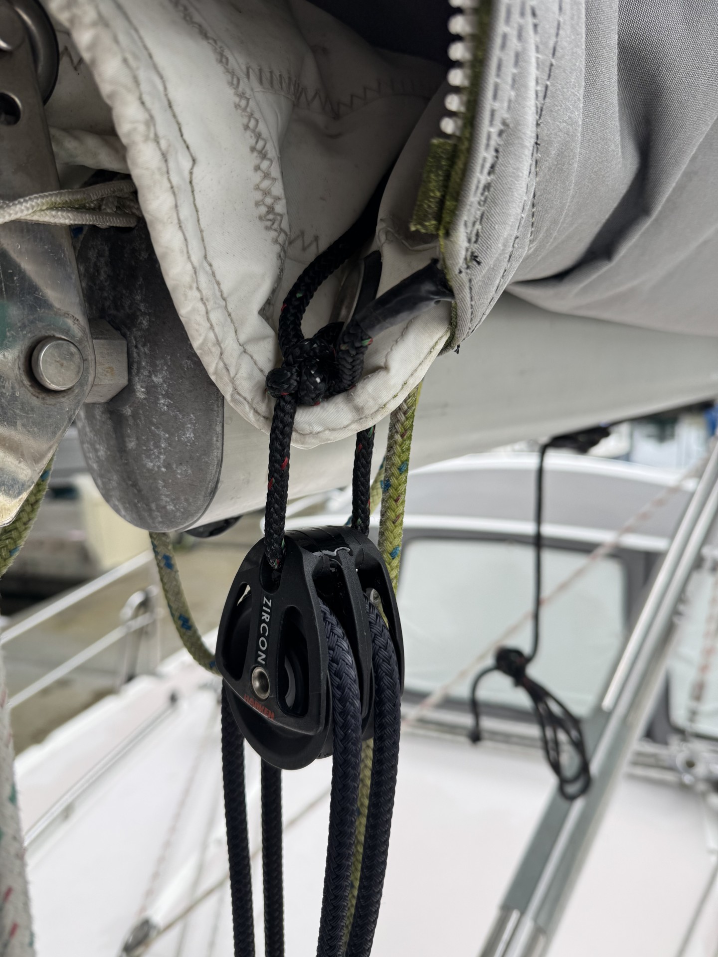

Hello! I Installed a cunningham a couple of years ago and am pleased with results. Easy to do: I looped a line around the main sail first reef grommet to a multi block with a becket just below the boom. The other end loops up and back down to a multi block with a cam cleat at the base of the mast attached to an existing bail at the bottom of the mast. It took less than an half hour to set it up. The atached photo sort of shows it, black lines at the mast base.
My sail is older, not worth replacing yet as I do not race. Having the cunningham allows much better sail shape control when wind picks up.
