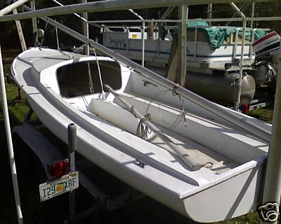

I have the one for the DS II (also fits DS III) but that won't really help for your DS I. The DS I did not have a plywood cover to close off the cuddy available as an option, so you may have to just design your own based on measurements of your boat.

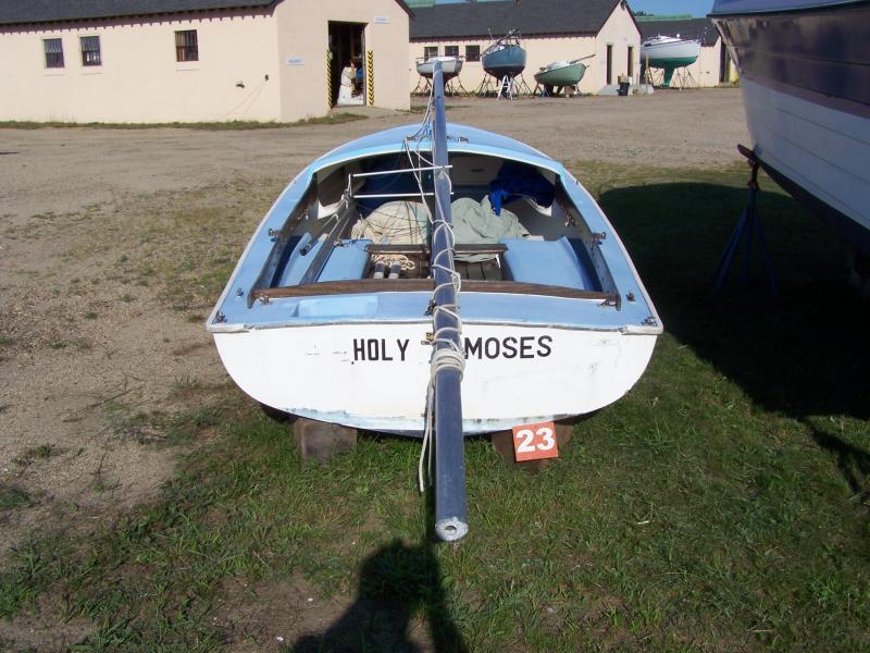

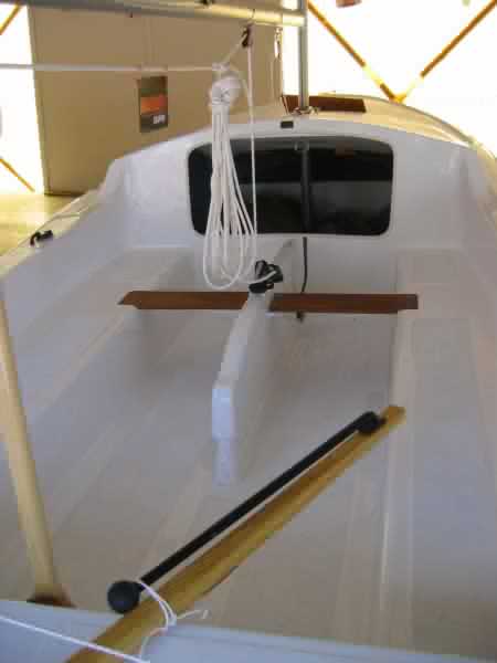

The DS I was completely open, no aft bulkhead on the cuddy. Seats were separate from the deck. The DS II and DS III had a molded-in cockpit and the cuddy gained an aft bulkhead, allowing the boat to be "self-rescuing" aka: usually able to be righted by the crew after a capsize (a hopefully rare event!) without filling up with as much water as the DS I would. The most recent version of the Day Sailer, the DS IV (Sunfish-Laser built from 1992-95 and Cape Cod Shipbuilding built from 1995-present) is even more self-rescuing since the cuddy can be totally sealed up. That does limit it's usefulness for easy-access storage though, especially on the SLI-built boats that only had a small, 12"x18" hatch!
The early years of the DS II had a smaller cuddy opening that had an optional vinyl-coated canvas cover, around 1973 the opening was enlarged and the plywood cover was offered.
