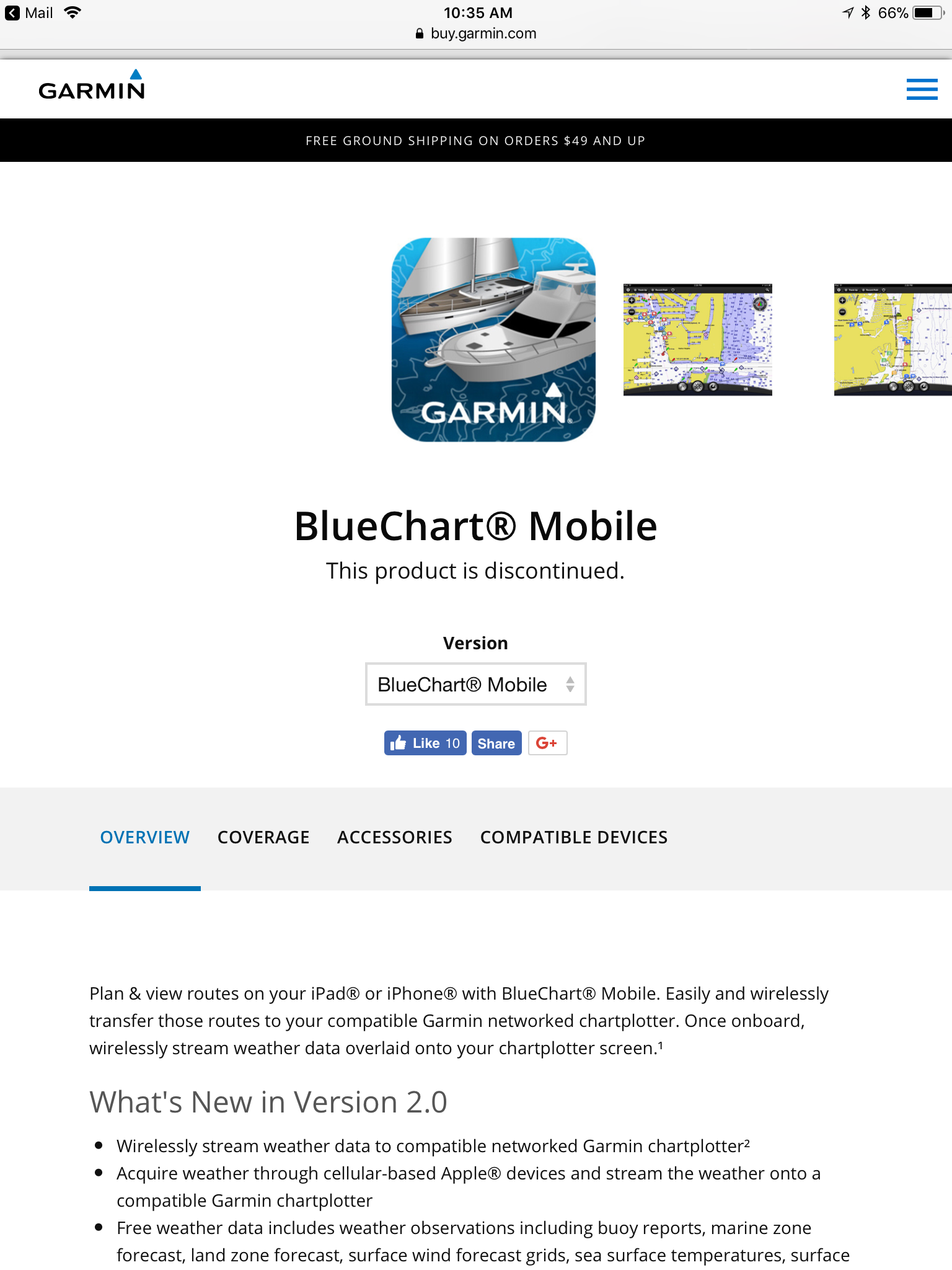

I’ve been using Garmin Blue Chart on my IPad in Europe. They recently stopped selling/supporting it, so I am starting to look into alternatives. Seems like Navionics is a good bet.
