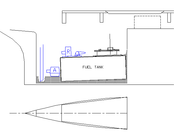

I next installed new shaft zincs, put the drain plug back in the rudder, and began restoring bilge and water systems. The mystery was then solved. My bilge system looks like this:
The small pump labeled (A) has an integral float switch and takes care of condensation, ice box melt, and sink and shower drains. There are twin pumps labeled (R). These are the emergency pumps which stay dry and unused until needed. The bilge alarm is located just below them for early warning of unusual water inflow. I had removed the small sump pump for the layup and filled the sump half full of antifreeze. When reinstalling the small pump, I found the hose from one of the “Save the boat” pumps disconnected. The outlet nipple on the pump was broken off half way along its length. The hose is heavy and stiff and I must have cracked it trying to get the small pump out. Left over tension in the hose pulled it off the pump sometime after I left. (Yes, I’m going to rethink this installation before too long.)
So, here’s what I think happened. I didn’t disable the bilge alarm because I figured the yard would call me if they heard it and I would have them hand pump the sump. It’s not terribly loud so the yard didn’t hear it even on their post rain jack stand checks. The bilge alarm ran the battery voltage down. Then when the water level reached the high pump float switches, the low voltage caused high current draw on the pump that has to push water through the long hose to the transom and it blew its fuse. The second pump then just kept pumping water around and around inside the bilge. I’d asked the yard to hand pump after rains by this time so the pump didn’t run long enough to drain the batteries flat but it still drained them far enough that I thought I might be needing a new pair of expensive AGM’s.

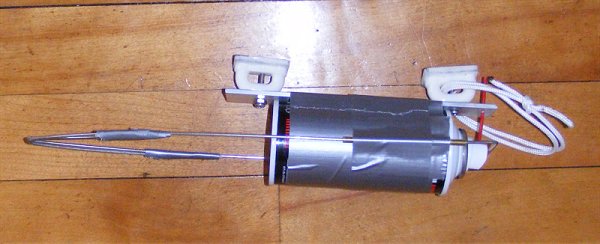

I was beat by the time I finished the fueling so I took a nap aboard and then puttered with small tasks like lubing the mast track.
More on lube gadget here:
http://www.cruisingonstrider.us/TrackLube.htm
I’ve posted pictures of this gadget before but it’s worth repeating with a mast stepping and unstepping costing nearly half a boat buck.
