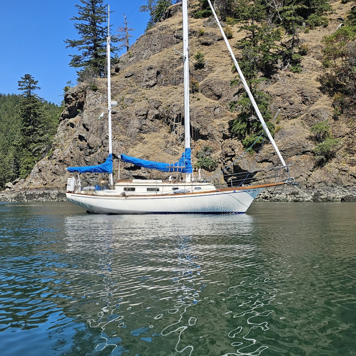

I made a crucial mistake with our most recent boat. It has an overhanging stern:
What I didn't think through was the fact that my wife (and my dog) are open-water swimmers. So, although we make due with a swim ladder off of the side, having some sort of platform would be nice, and that is pretty much impractical off of the transom. (We are considering a rigid-inflatable dock - just to have something.) Fortunately, not a lot of freeboard.
But ... I guess my point is that it is better to make your criteria mostly as use-cases, rather than specific features, since there are multiple ways to accomplish most things.
