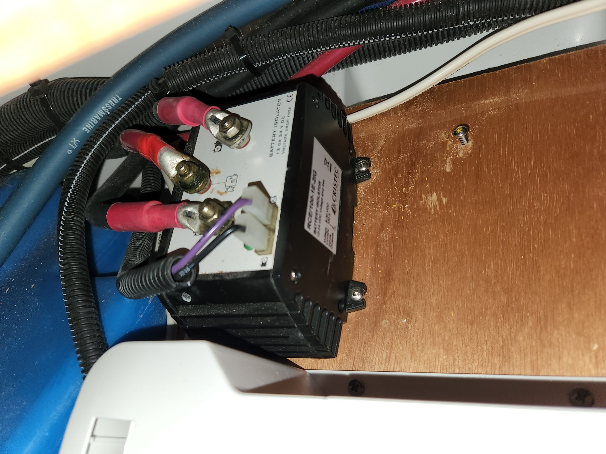

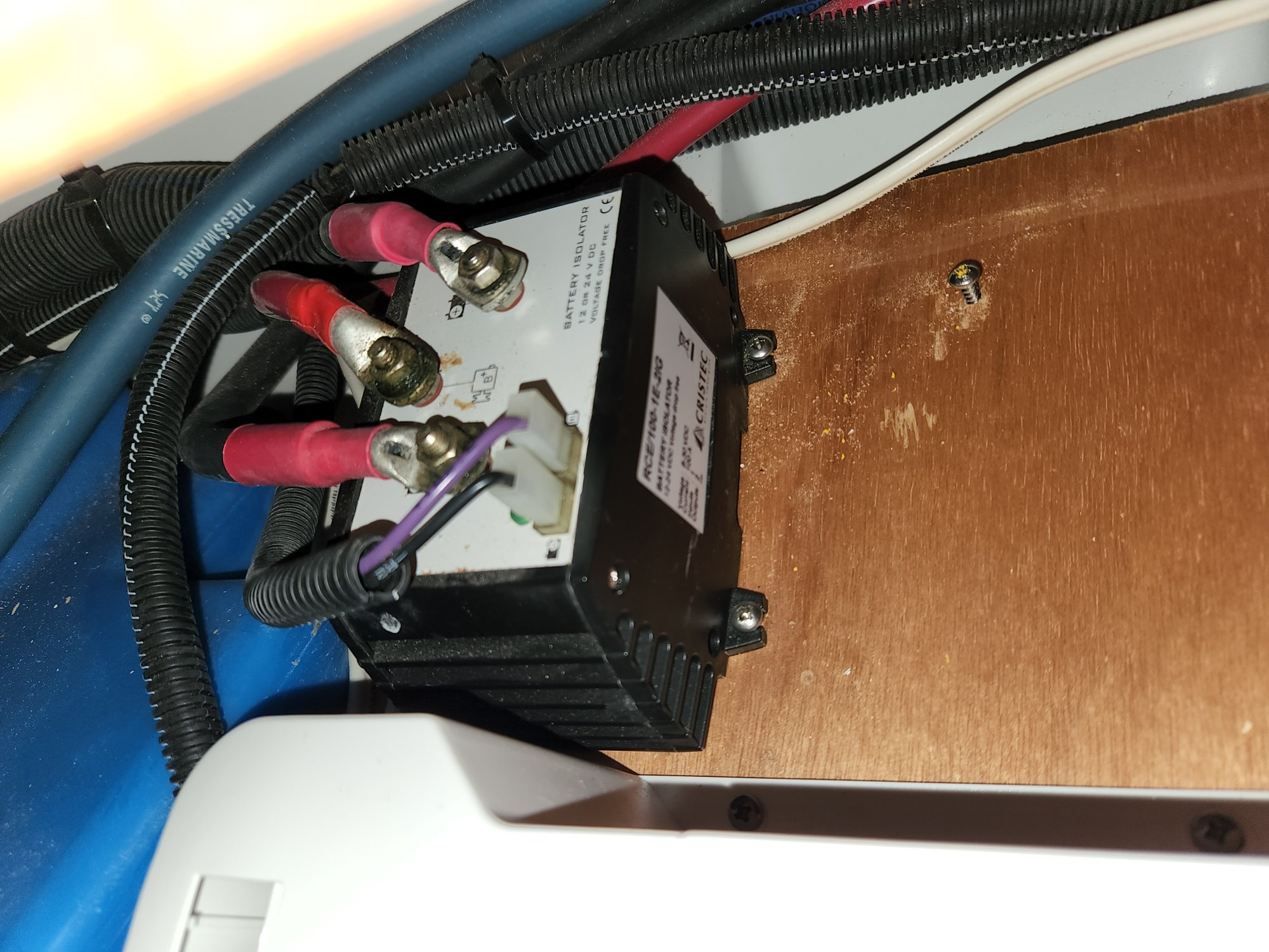

I've been chasing a voltage drop issue with my new alternator installation. I did find an issue at the house bank connection, it was tight and it looked clean but it was dropping 0.5 volts at only 5 amps. I cleaned it and now it's fine. But I still have about 0.7 volt drop between the alternator and the batteries. I figured it was probably the ground but it was not. My boat was factory equipped with a Cristec 100 amp battery isolator. Beneteau used the wrong lug on one of the cables and added 2 extra washers on the connection. Beneteau also used loctite instead of dielectric grease. I cleaned up all the connections and reassembled it but still have the same 0.7 volt drop. This is not a diode based unit it is supposed to have about 0.05 volt drop not 0.7. Is this the typical failure of MOSFET based isolator?

The drop is between the alternator post and the house bank post. The washers are on the top and bottom of the alternator connection lug. I do not think it's a connection issue. The voltage drop is measured post to post.

This was taken before I cleaned the connections.
Remove the bottom washer. It may be part of the problem and it is dangerous. The additional resistance from the washer can cause the connection to over heat, which besides being a fire hazard increases the resistance in the connection. Second because the SS washer and the lug and bolt are different materials they will expand at different rates. This can cause the nut to become loose and subsequently the connection will become loose.

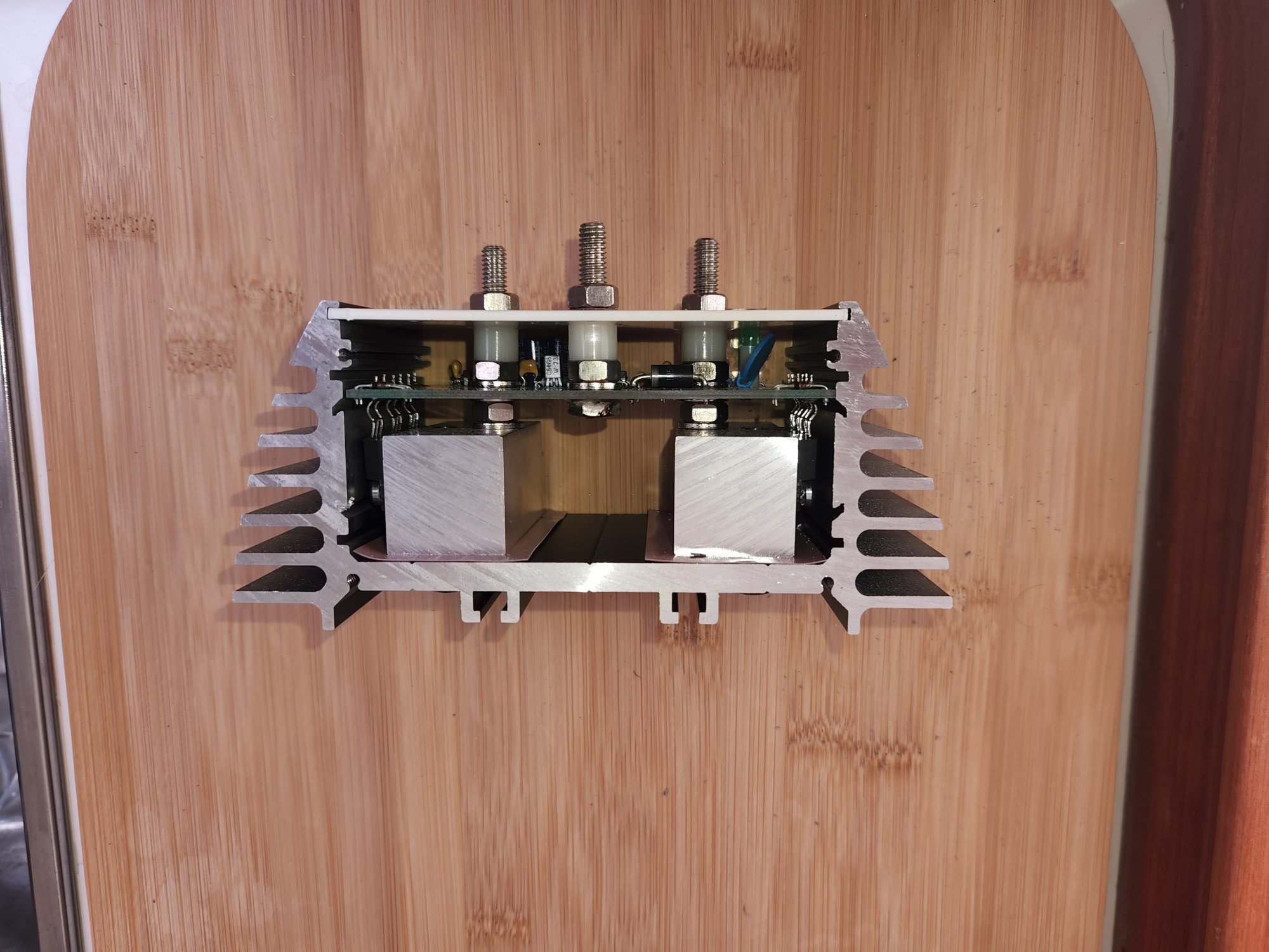

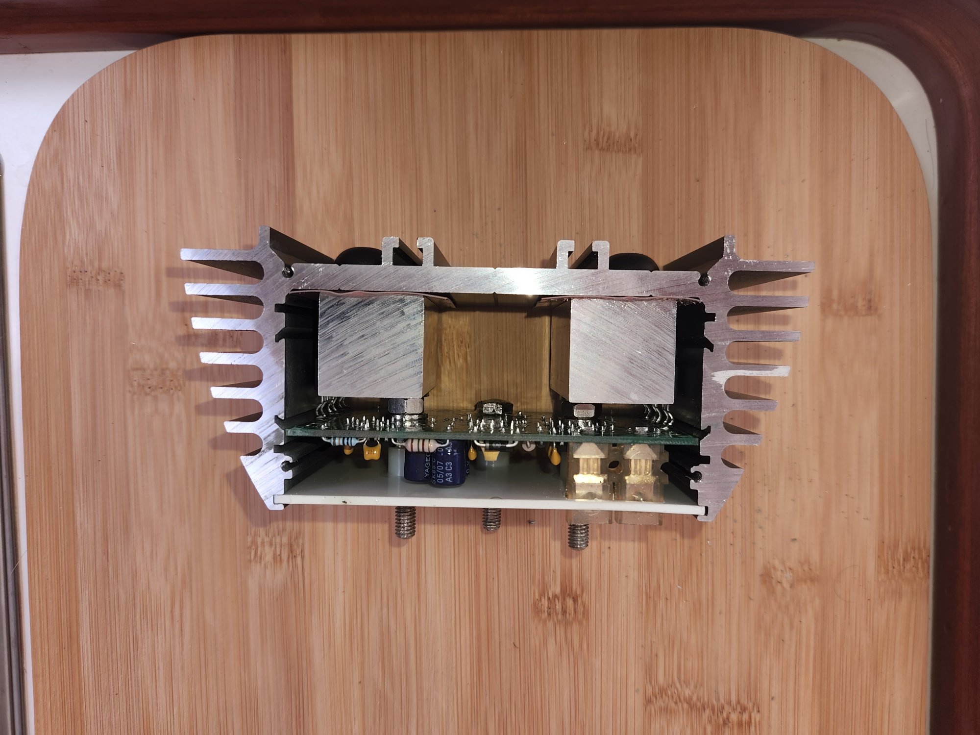

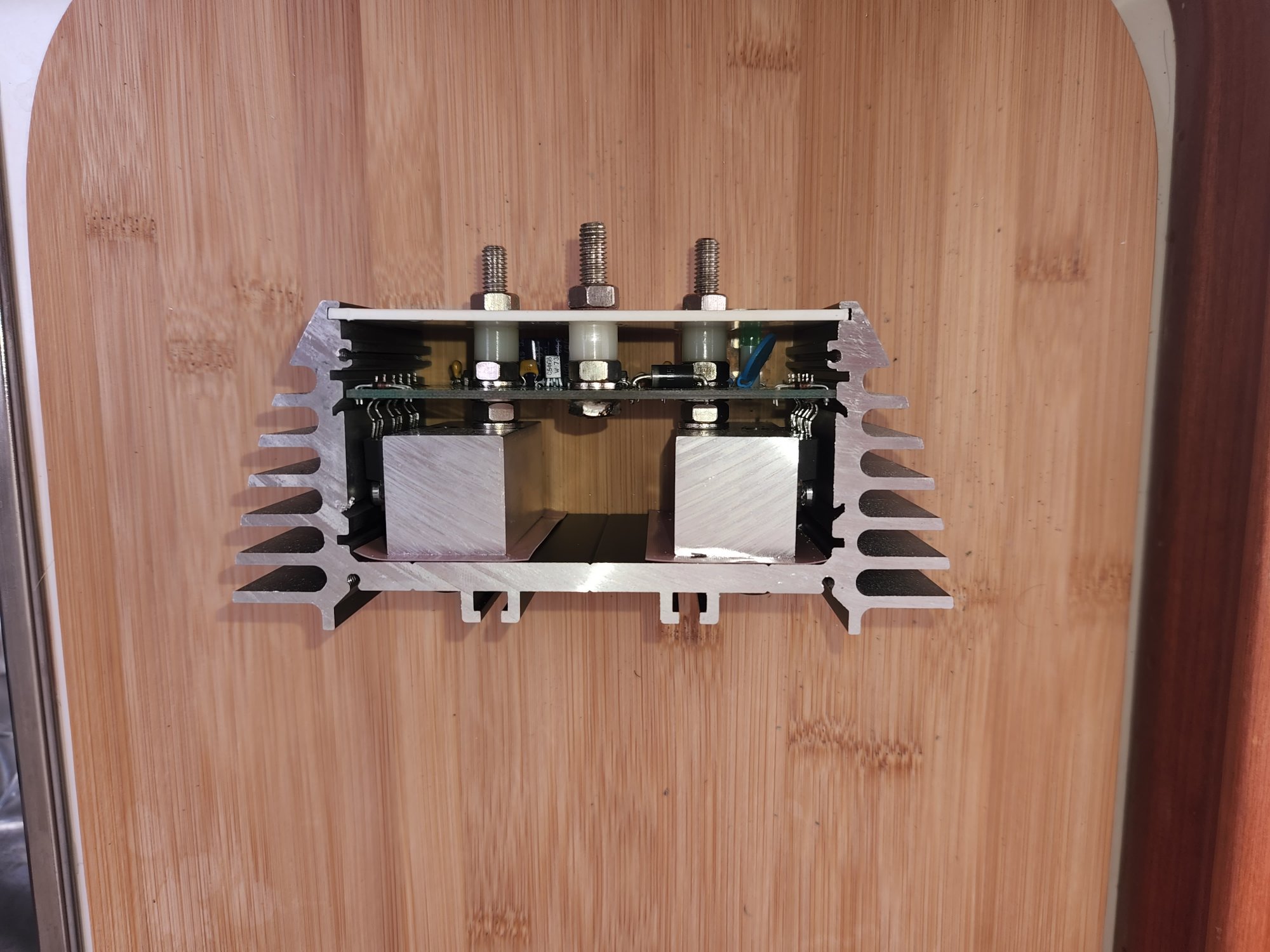

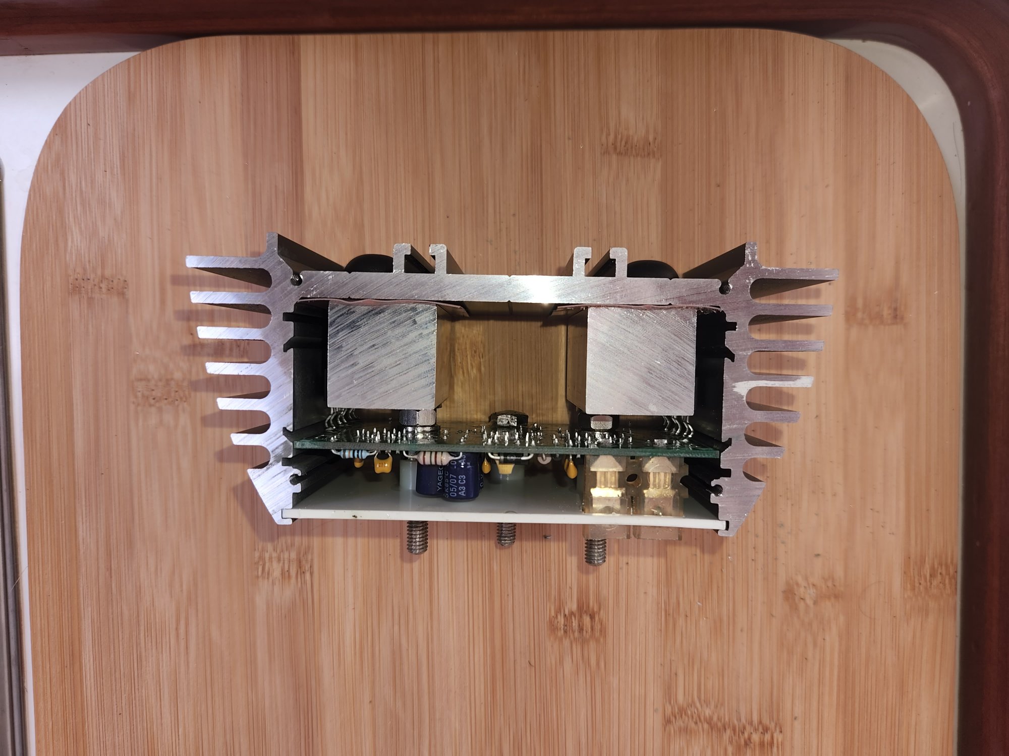

Today I removed my battery isolator and took a peek inside. Nothing looked out of the ordinary. I cleaned the posts again and reinstalled it. It still has a 0.7 voltage drop across it.
