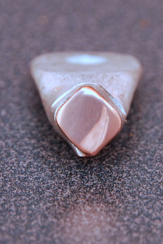

I have personally cut open crimps made in a vice and they are not properly cold formed and still showing individual wire strands. High amperage cable is no place to cut corners and possibly create unwanted resistance.
This is what a properly cold formed lug looks like when cut open then polished to expose any pin holes or visual voids. As you can see the lug and wire visually become one large solid mass of copper.
