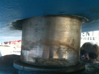

Not sure if a creaky rudder is the same as a squeaky rudder but I posted a similiar problem and have since solved it.
See photo: The stainless post was rubbing against the bearing on the port side causing the squeak. The rudder was dropped 6 inches with the boat on blocks.
Easy to do. The stainless post was sanded with 600 grit and solvent to clean it, silicon grease applied and rudder re-installed. Squeak gone!
How long it will last I don't know. If need be, one could completely drop rudder and sand away some of the plastic bearing where it rubs but I prefer the grease and cleaning, even if I have to do it once a year at haul out.

Re: my squeak solved
Thank you for your reply Captain Gadget. My problem is at the top of the post where the stainless sleeve is bonded. There seems to be a small fracture between sleeve, epoxy and fiberglass post. This creates a cracking type noise, not a squeak. Think I willl drill around the post and inject epoxy. If this does not work, I will drop the rudder. The bottom was painted last Sept. and was hoping to avoid another trip to the yard. $$
