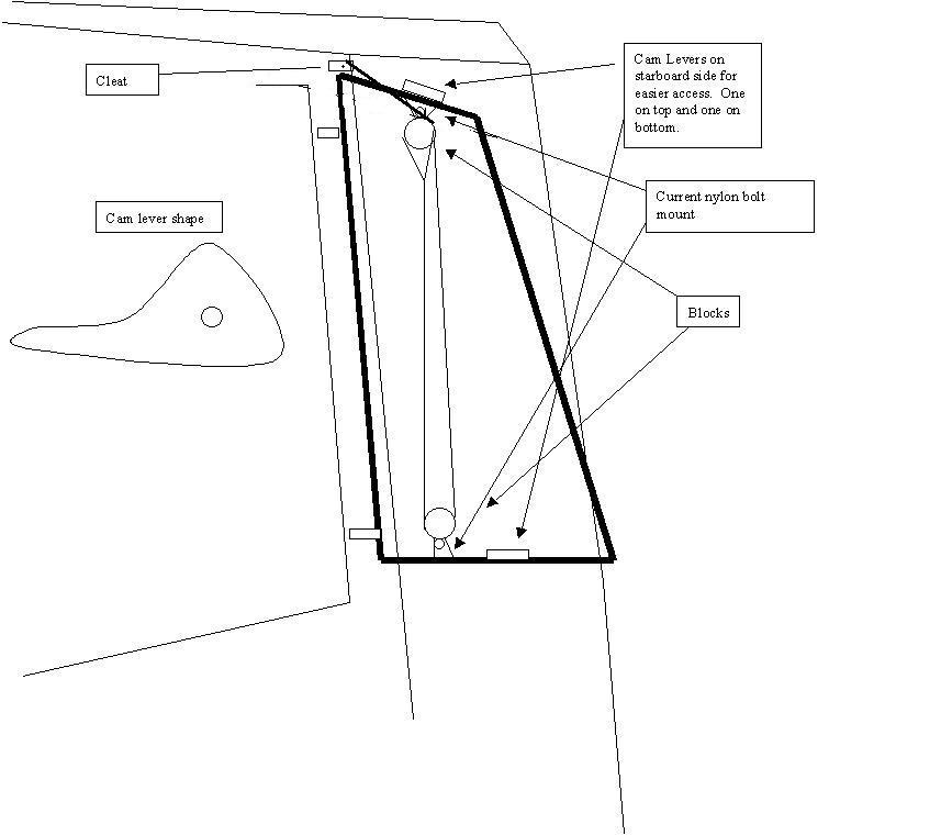

Ok, I've been following some of the posts about how to rig a lifting mechanism for lifting the rudder and one of the big concerns was keeping the rudder locked into the mounting 'harness'. In the attached picture I have done a rough drawing of the assembly. The basics of this idea is that it uses the existing mounting points for the nylon bolts to hold two blocks, one top, one bottom, to give the system 2-1 purchase and the line terminating at a cam cleat mounted to the tiller. Two cam levers could be made and mounted to the top and bottom of the alum. frame. Starboard could be used to make the cams.Whachathink?
