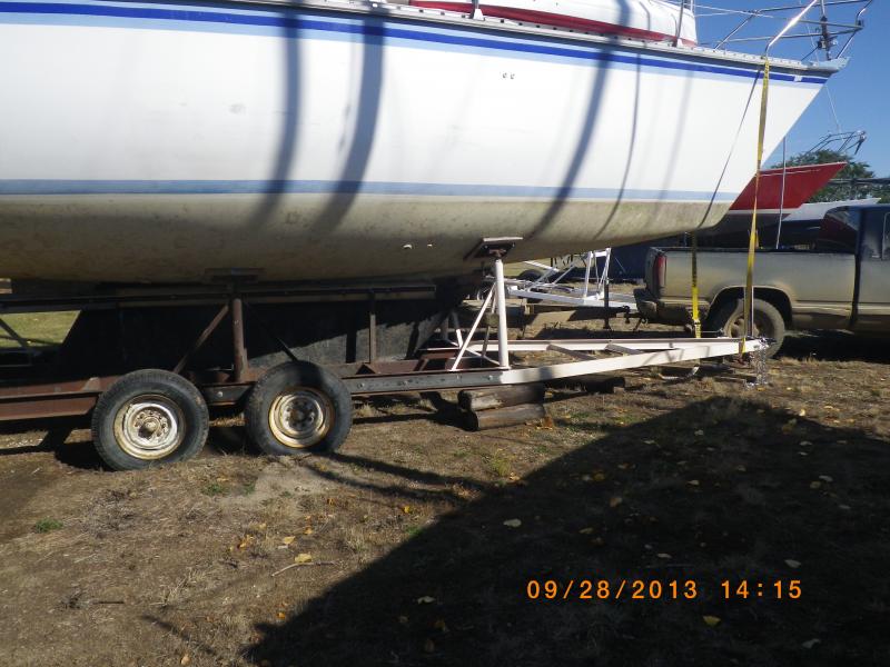

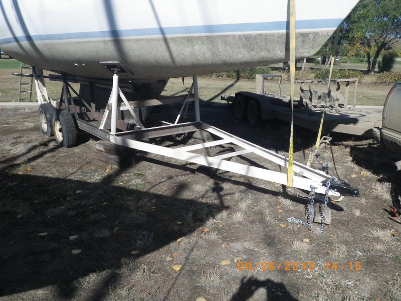

Here's a couple of pictures of the homemade trailer. I pulled the boat using this trailer this fall. It work well, the biggest thing is to make sure the pads don't move until the weight of the boat is on them. I can supply info to anyone who wants it on how I built this.

It's a hunter 34
I've used the original cradle that came with the boat. It has 6 pads.

Are you sure that two axles/wheels weill support the H34's weight all-up?

I don't' think it will be an issue as the axle's are 7000 lbs each. And it's only going to be a yard trailer. From all I can find the all up weight is about 12,000

I didn't use any springs as I wanted to keep the c of g as low as possible. I only have to move it about a half mile from the ramp to the winter parking lot. I have 16.5 rims 10 ply tires so they should be good for the load as well.
Yikes, I hope you dont have to go up or down any driveways and that your tongue height is perfect on the truck. Springs aren't just for a soft ride, they also keep both axles sharing the load. With no springs or cantilevers to equalize the load between the axles any time you pitch up or down it's going to transfer the full load to one axle. I've seen many a bent axle from this exact scenario. With 12,000lbs on a 7000lb axle I wouldn't be surprised if you snapped a spindle off going over uneven ground.
