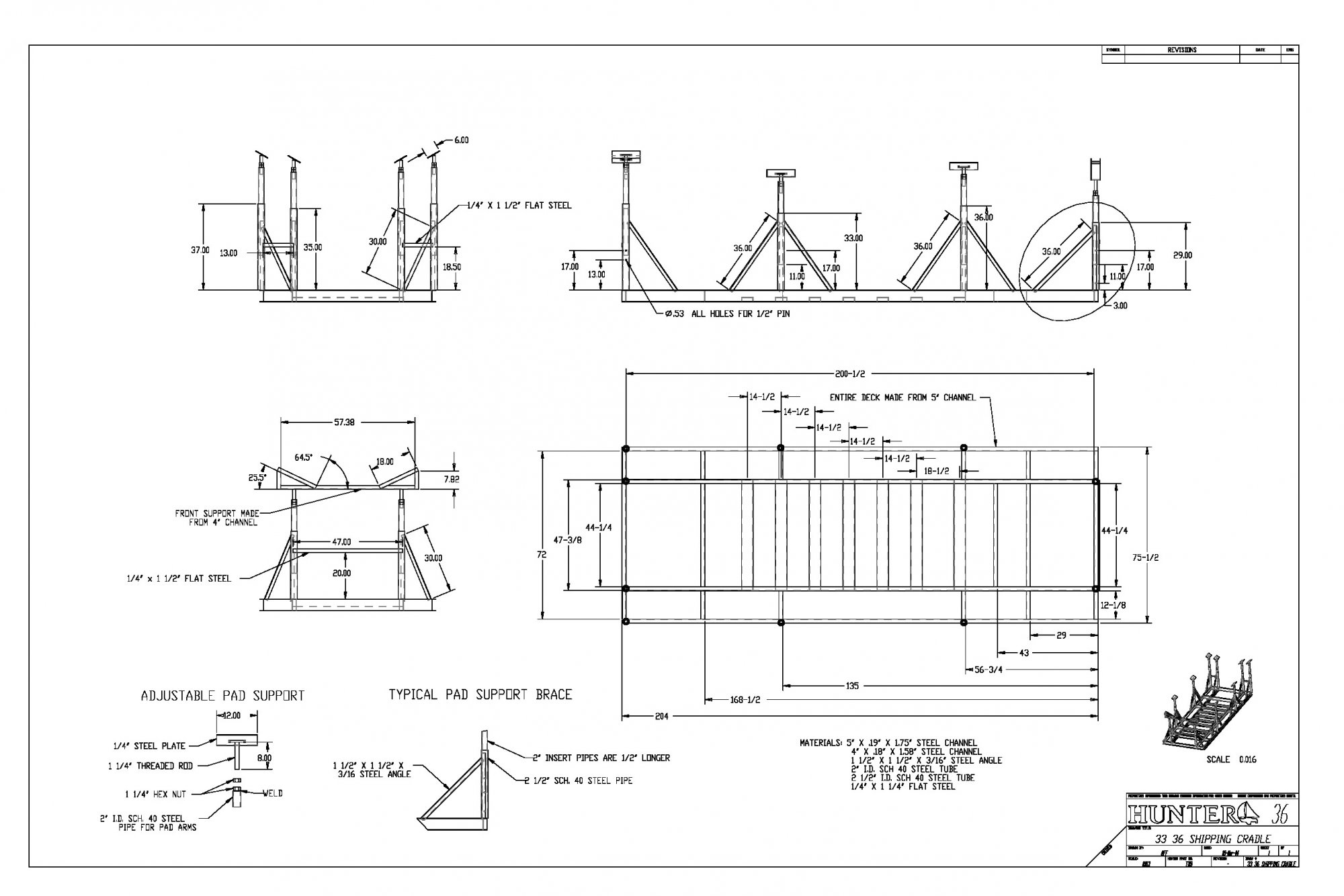

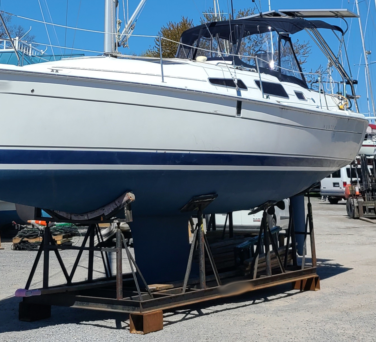

This past spring I watched to marina staff doing an altogether too complicated dance trying to drive the cradle out from under my '07 Hunter 33 when hanging on the straps. The crowded early season boatyard limited their mobility and my pads couldn't be removed to provide enough clearance (the Travelift was at the maximum height without damaging solar panels, etc.) due to the full-length tubes on the stock shipping cradle. I'd like to modify the cradle to make it simpler to pull the pads, and easier to adjust when getting seated for the winter.
Currently, the threaded rod under the pads screw into a nut that's welded to a full-length steel tube that runs to the bottom of the 2 1/2-inch structural pipe. Adjusting the height requires putting a big pipe wrench on the tube below the gnarled-up welded-on nut and spinning that entire tube.
Ideally, I'd like to cut the tubes shorter, weld thrust collars up high that'll ride on top of the structural pipe, and add handles to the nuts.
Anyone have experience with such a conversion?

It's the original shipping cradle from Hunter. Having the option to readily remove the pads is what we're after, regardless of whether the yard "should" be able to jockey it or not. Clearly they've been doing the dance successfully for years (the boat's been at that marina for years before I bought it), but I was there to witness the challenge they faced & the yard manager & travelift driver were thrilled when I suggested the mod.
I'm most interested if anyone here has made the conversion, or done anything similar.
