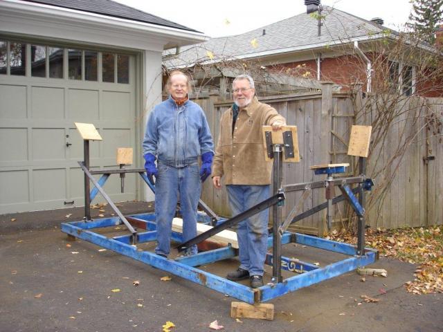

Jim Kelly and I finished the cradle for his 270 today. Jim was able to salvage alomost all the steel we used from an old non-folding cradle that was being scraped at our club. We have not tried the boat on it yet but there should be enough adjustment to play with it should be fine. It gets picked up tomorrow morning and delivered to the club, and should have a boat on it next week
I got a lot of help from Mike on this board who supplied us with the critical numbers to build this cradle. Thanks Mike for a job well done.
We included two extra support pads in the hope it could also be used for a 260 should I need to replace my center board uphaul or put some anti-fouling on.
Bob

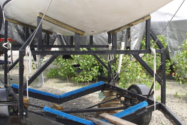

I think ultimately I would like to be able to lift the boat up a couple of feet myself while it is on the trailer in my own yard. It should be possible to build a frame that fits between the hull and bolts to the trailer frame and will lift the boat a couple of feet in order to drop the center board or paint the bottom.
There is a picture below of a frame I made for my last boat that bolted to the trailer frame and allowed me to move away from the crane and into the yard for painting etc. I called it a "tradle" :D.

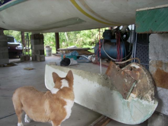

I lift my 260 by jacking the trailer and boat off the ground, Blocking the bow and stern, then lowering the trailer. I off load all the weight I can before starting. If you need another 4-6" after it's blocked up just deflate the trailer tires too. You can get a foot or two of clearance which is enough to bottom paint or drop the CB but be very aware of the stress on the boat and limit the time it spends on blocks/jacks fore/aft to no more than 3 days. That timing's only a guess but it also motivates me to get the job done. I strap it to the ceiling and pull out my trailer because I can, but it'd be pretty easy to just leave the trailer under it too.
There are virtually no flat spots on load bearing zones on a 26/260 so brace accordingly to distribute the load. I've found that a nice green/wet deck board(sightly thinner than a regular 2x6) will bend between uprights to help support a curve like those in your pics above. I used regular 2x6 on the long spans of my trailer but found them too stiff in shorter spans and 2x8 just far too stiff for these egg shell thin hulls. Add carpet if you're in love with your boat.
A CB removal needs 14" of space between the bottom of the CB at the head and the trailer to drop the bracket and CB. Just did mine and it was far easier than I thought it would be. A 20" x 3/4" threaded rod to guide it back into place is the answer to bolt alignment hell. Finally seal the finished bolt head with 3m 5200 which is easily removed with a $10 harbor freight heat gun if you ever need to loosen it again.

Changed my CB line with a higher quality line but not Spectra or anything too over done. It could've waited a couple more yrs although there was an oyster growing immediately next to the line that would have done it in soon. Also the main bolt was severely damaged by corrosion or a lightening strike before I'd owned the boat. I'd hate to think of it failing.
The CB is never fully retracted so don't fret, imagine the strain to get it fully horizontal. Ck the scum line on the CB pic above. They all droop some.

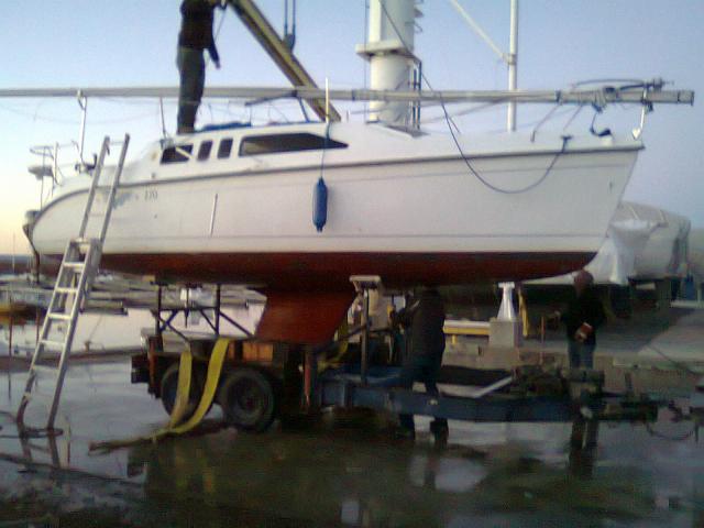

Jim Kelly's 270 was put on the cradle tonight, we had to put a block under the keel with the pads all the way down, otherwise everything was smooth, pictures of the event below, Bob
