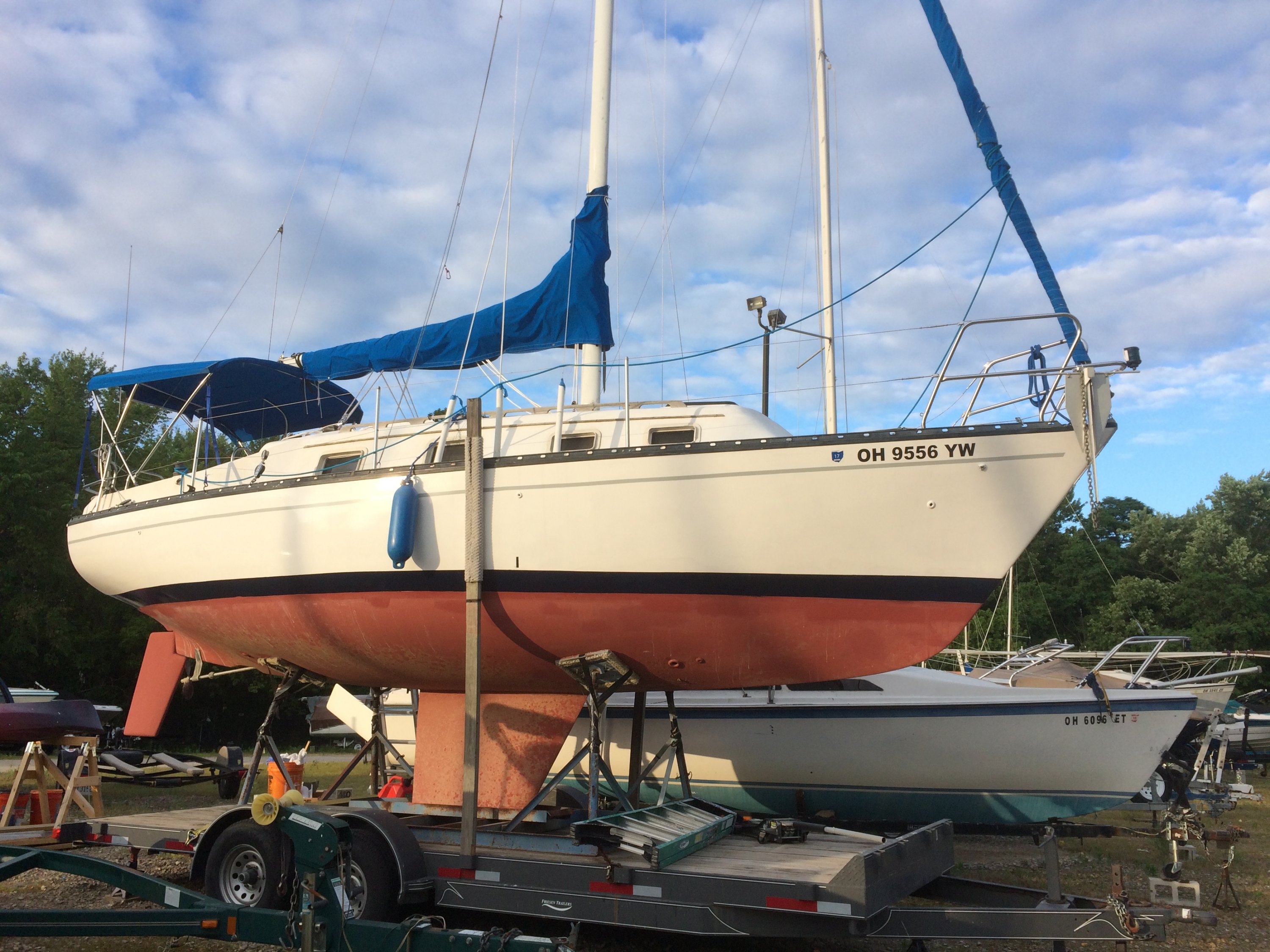

Well, since the OP isn't responding, I think I'll hijack his thread.
Dave, I know the trailer will make it from Ohio to Mobile Bay, but do you think just 4 supports will keep the boat steady enough, or should I have 2 more welded on for each side?

Is that the specific trailer mentioned above in the picture I am looking at? If so, we need to talk. Private email with phone number. I have used construction trailers in the past but it can dicy moving a boat on a cradle top of a construction trailer. If the mast is stored on top of the boat during transport, then you need to know the height at the end, middle and front of the mast alone to see if it is below 13 feet 6 inches. That alone you do need some clearance. I appreciate your response since the original poster did not even respond to my private email either. There is a lot more to be discussed
10,469
-na -NA Anywhere USA
Gorilla Toast sent me a private message with his phone number yesterday and had a good conversation this morning, Saturday. He appreciated that I call. Although the original poster never responded, it indicated a later model 27 which I was very knowledgable as I had sold nearly 20% of the production line having introduced the boat for Hunter and even had a trailer designed for it not to mention a mast raise system I built for a couple over the years. That said, Gorilla Toast advised the above boat is the one seen above on the actual construction trailer. Height alone is 13' 6" from top to bottom and the over hang from the trailer is more than 6 feet. I told this gentleman I was familiar with the model as I had maintained one for a Scout Camp for years.
Although the trip would be via I 65 to I 10, with the mast on top, height alone is going to make this trailer out of the question. Over the years I have found various state highway departments sometimes do not change or adjust the bridge clearance and once you get off the interstates and going to get gas, sometimes height is a challenge. Although I have used construction trailers with cradled boats, I advised this is one I would not suggest doing give the above factors based on safety. Gorilla Toast is going to find some haulers and I advised against u ship and others like that as most are not set up for this style boat. I suggested that he would be best to ask but I will for him. If you know any good transport companies folks, would you please send him a private email via forum email. I know he would appreciate your comments.
