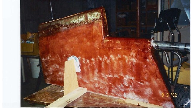

It has been a couple of years but I think that I drilled holes where I faired the epoxy on the rudder. I wanted to make sure it would stay. That part of the rudder has that hard, shiny look under the paint. The rudder seems very solid and I have put off the major project of opening it up. I have wanted to see what the inside looks like but I think, possibly because it has always been in fresh water, that it might not be necessary. Maybe just an additional wrap of cloth and more epoxy would satisfy my paranoia. :) Did you see the photo essay that Gary Henkelmann posted? He added a couple of inches to the leading edge while reglassing. I'll try to post one picture here.
