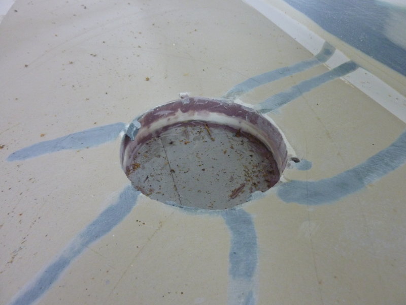

Unless you want to re-finish the decks I would advise just living with them. The only way to make them go away is to Dremel them open, fill, fair and re-finish. Gelcoat can be very tough to match and you could spend hundreds of hours blending, fairing and buffing and still not have a match two years out, even if you got it spot on today..
This is what it will look like after being routed, filled and sanded.
