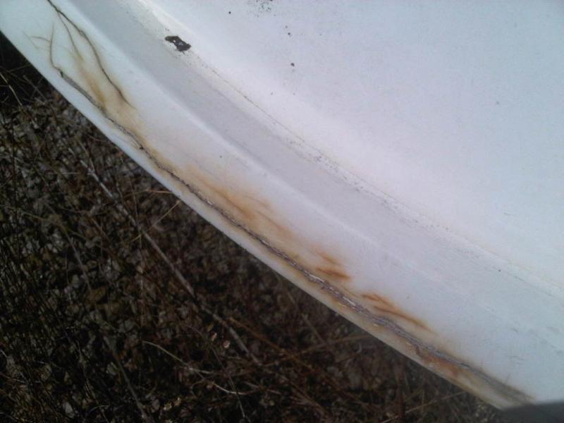

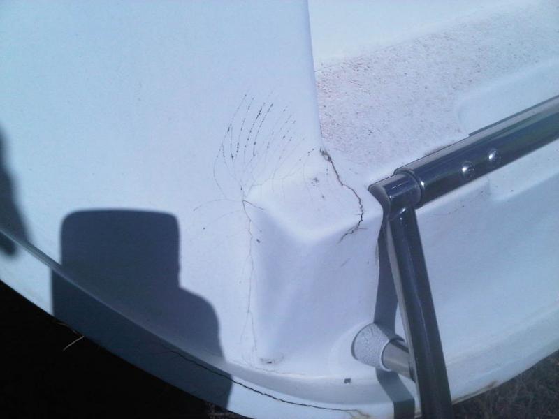

Dave,
I finally got some pics for you to view. Any help appreciated!

Thank you for the photos but I would have responded sooner if sent direct to me and then I would have advised the forum.
We are dealing with two seperate issues. Lets' deal with the hull to deck joint which is easy. First it has been a while and will need advice from the forum. WAS THERE A RUB RAIL ON THE BACK OF THE TRANSOM AT THE HULL TO DECK JOINT?
The hull to deck joint is married via marine putty finsihed off with gel coat. First, you will need a dremel to take out the old putty to the fiberglass of the hull and deck joints. Then you will need to sand getting the excess putty off and do not be afraid to go all the way into the boat as that is what you will have to do as long as you are taking out the affected cracked putty. I then clean with either acetone or alcohol. I would then apply a two part epoxy and I use what is called Water Tite. Yes it is expensive but at this point you want a strong bond and it takes over night to repair. Then sand smooth and apply white gel coat. You can mask off the area and no one will notice the discolor of white. White is hard to match. I have seen folks use Krylon white spray paint for plastics but not sure if that will work butr if you do, make sure the area to be sprayed is lightly sanded for good adhesion and let dry over night although the drying time is fast.
The other issue is in the gel coat near the ladder which is cosmetic. I would dremil out the crack into a V angled outward from inside to outside. You can order white gel or buy it from a marine store but it is expensive. If you feel that you are not capable of repairing these cracks, do what the other fellow suggested and get someone who knows how.
