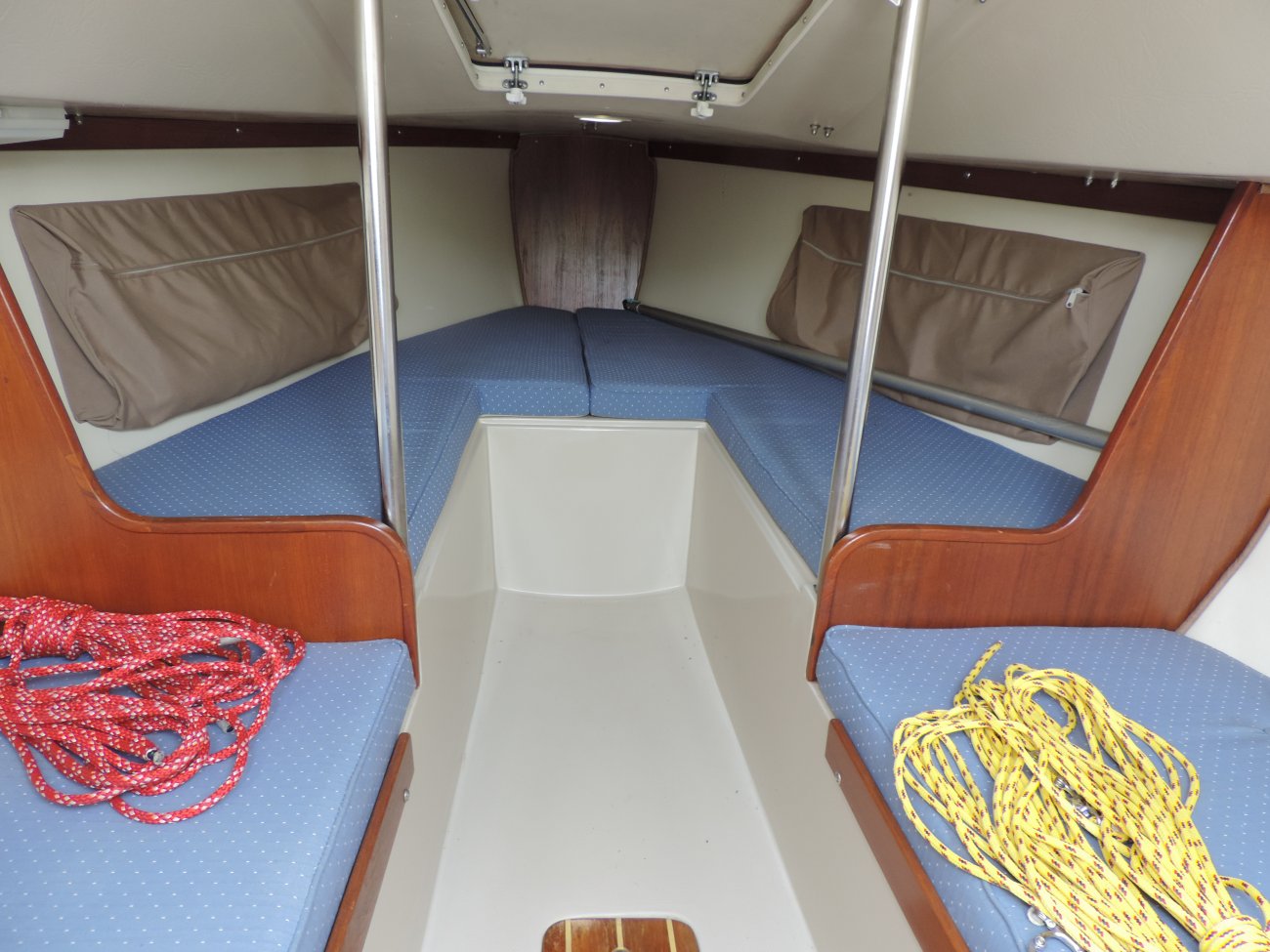

The early Capri 22 had a wooden transverse beam that supported the deck under the mast. It was in turn supported by two stainless steel "compression posts" on either side of the porta-pottie. The below picture is of my '89. If the mast step is not properly sealed, water can begin to degrade the beam, which in turn can result in the deck flexing under the step. Later (Mark II) boats went to a single compression post directly under the mast. It is my understanding that this was done to reduce the likelihood of issues developing, albeit making access to the porta-pottie much less convenient.
In my opinion, if properly maintained, the old design will hold up just fine (lots of older boats without cracks, including mine). The design is similar to many boats with deck stepped rigs, so not unique to Catalina.

I believe you get the cleanest interior award for any year let alone it's a 30 year old boat! Wow, great job!
Jul 28, 2016
95
476
While I would love to take credit for this, the picture was actually from the "For Sale" ad on Craigslist when I bought the boat a couple years ago. Unfortunately, it is much more cluttered these days!
