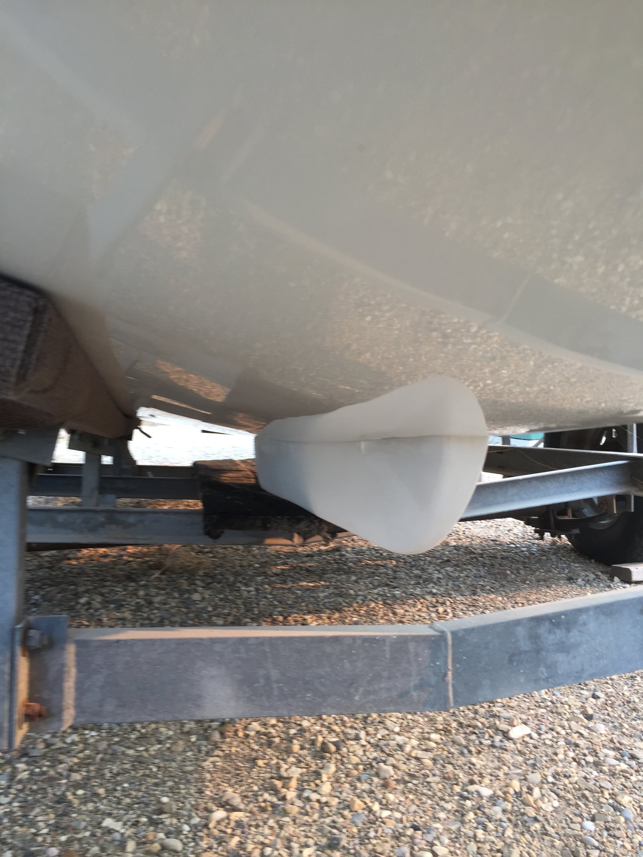

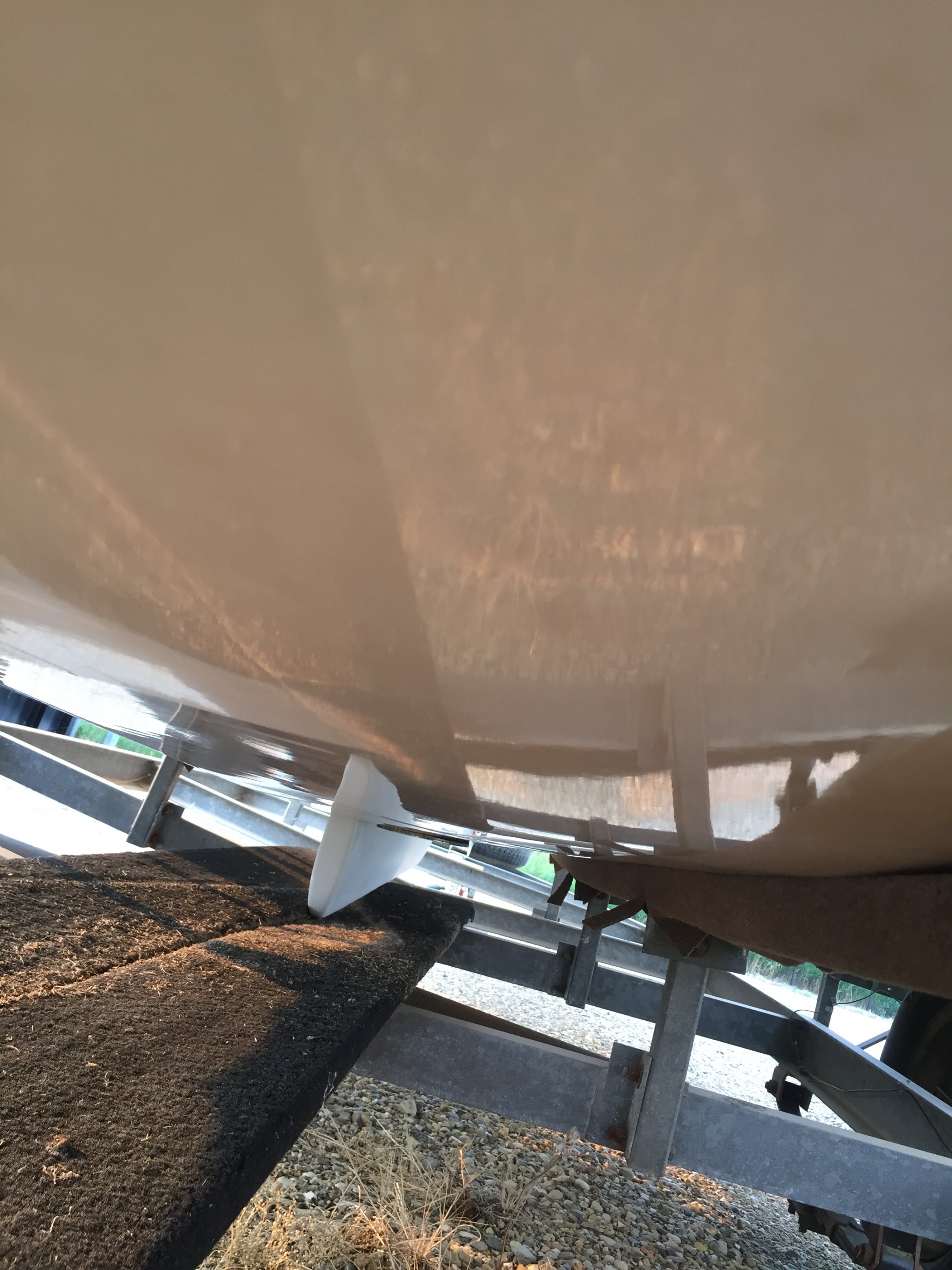

So that boat got fixed and it looks like new . They had to cut back to where the balsa core was dry
I'm going to help the owner launch her on Saturday we will see how she sails and if she is water tight.
