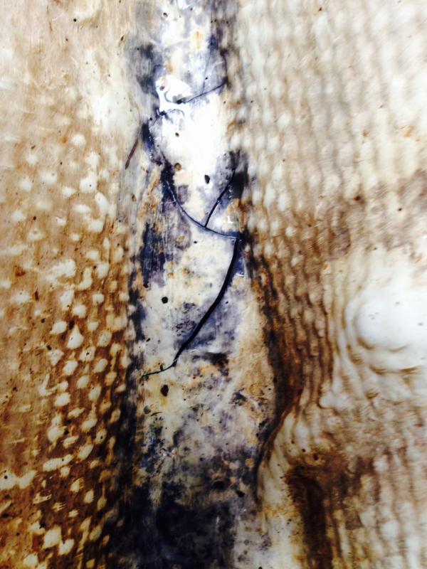

crack in the bilge under the transmission
Aug 3, 2009
35
Catalina 30 Everett, WA
:eek:This is what we found after pulling the Atomic 4 and scrubbing the bilge. Is this crack something we should be concerned about? Could it possibly be a too hot batch of resin when the hull was originally poured back in 1978? How should we fix it? It's not leaking and actually our bilge stays quite dry.
Jan 12, 2013
114
Catalina C27 - Tall Rig Door County, Wis
I may clean it out and fill in with some epoxy to seal out water intrusion and if re cracks I would look closer
