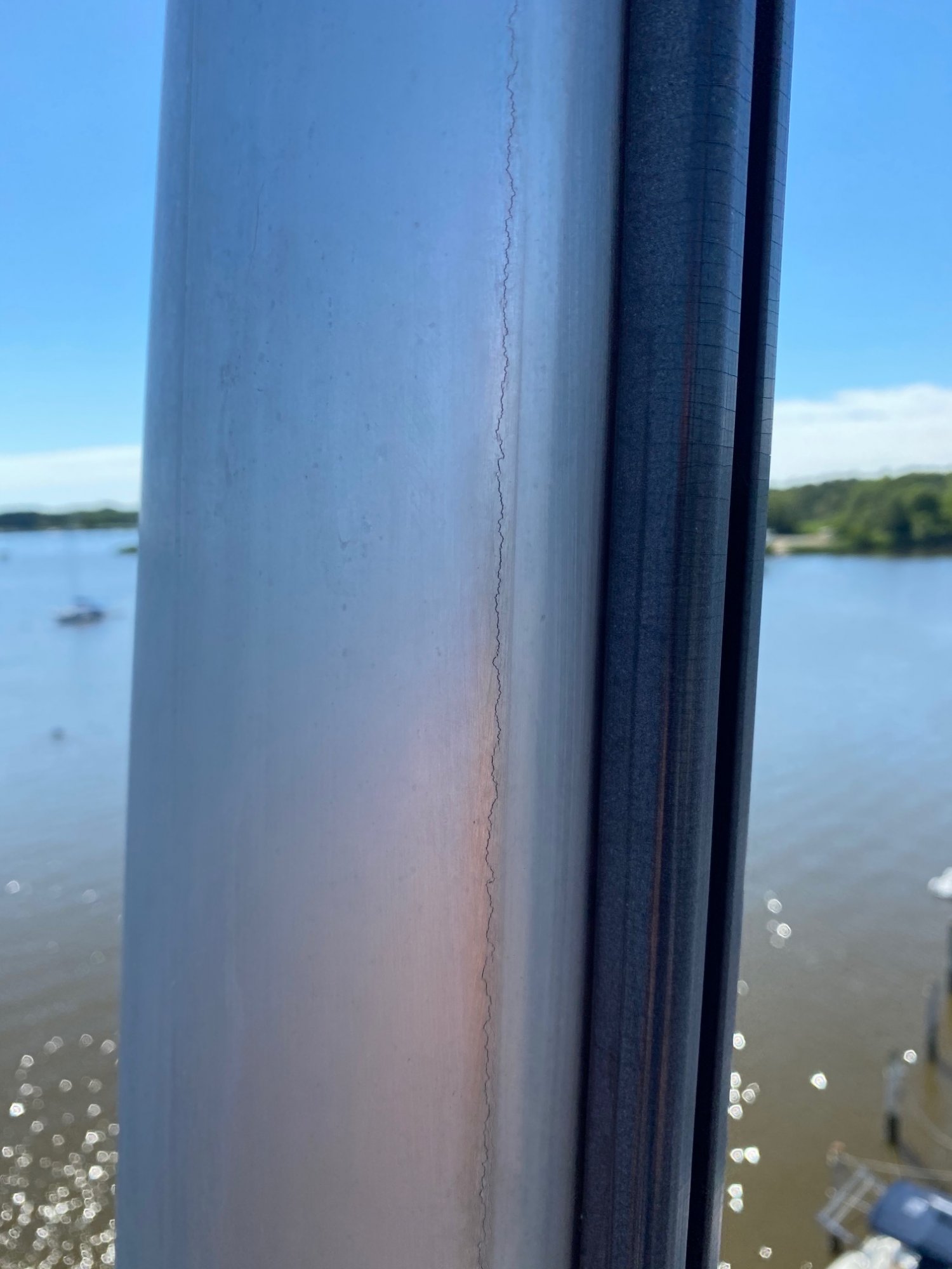

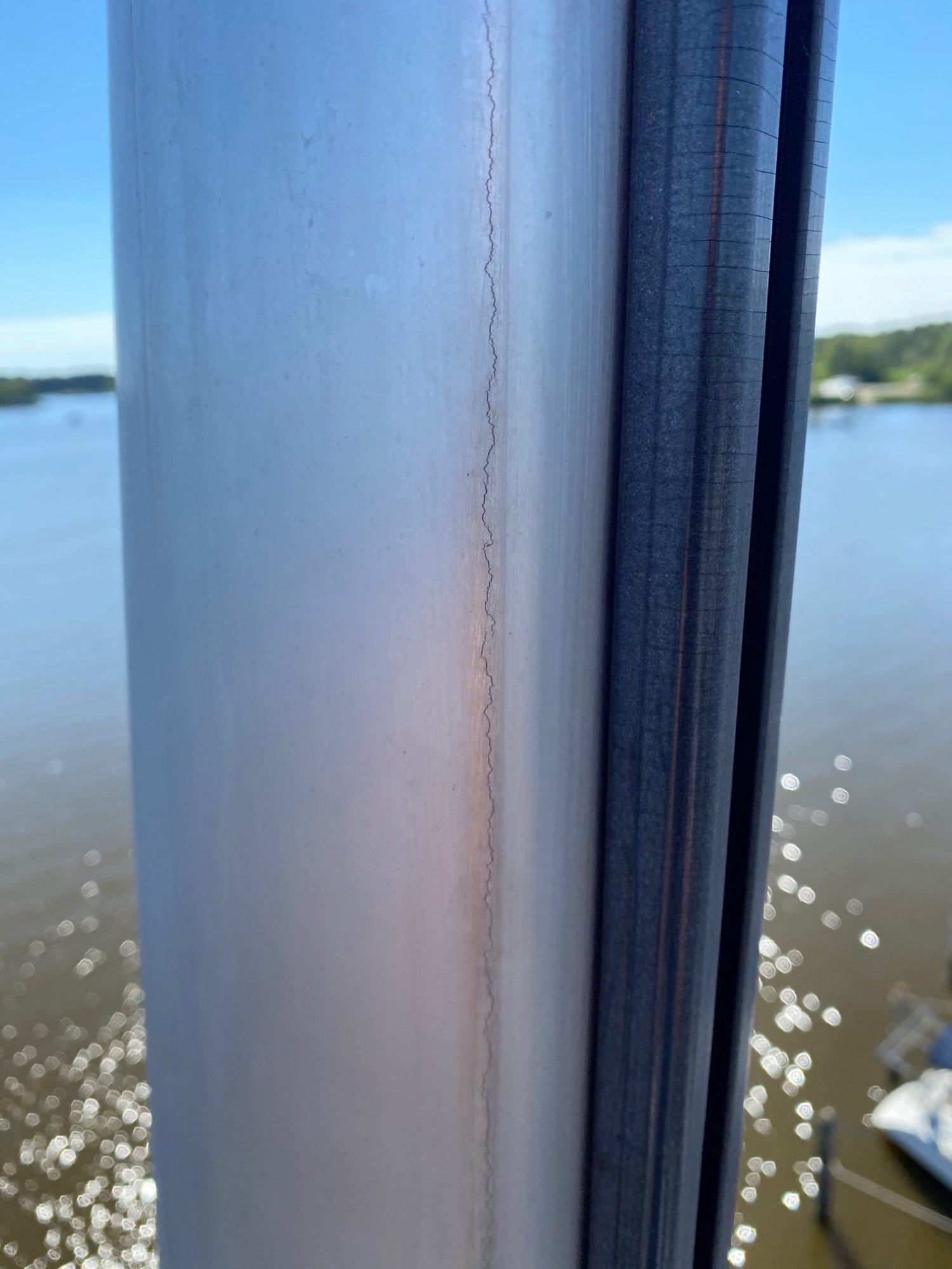

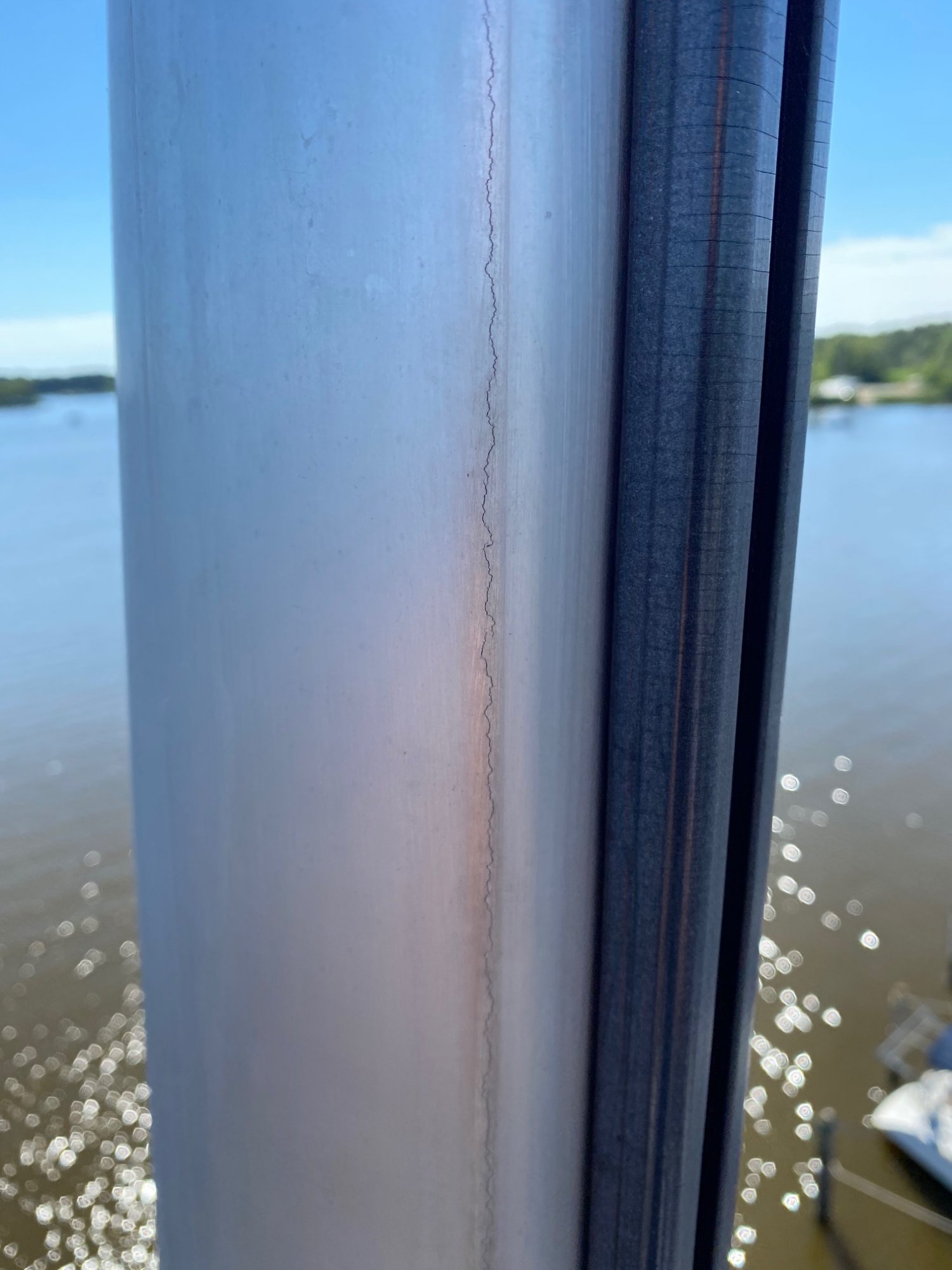

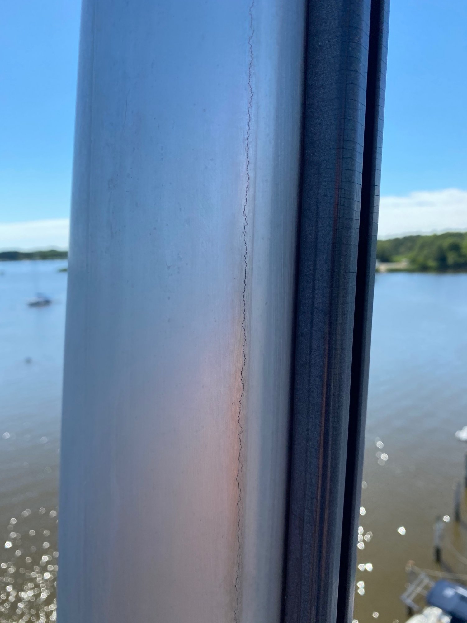

Just purchased a 1998 Hunter 340. Had rigging inspected after purchase. Rigger found a crack in upper mast section (see pics). Anyone else ever had this problem? Any option for repair other than mast replacement? Thanks.

Congratulations on your new sailboat and welcome to the forum!! Suggest consulting with one or more expert aluminum welders on the feasibility and options to repair your cracked mast before you replace it from a number of mast suppliers. Options to repair the mast are discussed in the threads below. They include:
  • Sleeve and weld
  • Weld it (by an expert aluminum welder)
  • Make a rectangular plate bent to the side curvature out of Al... Slightly thicker than the mast... I'd overlap the crack ends by 4-6"... Drill a hole at the crack ends to stop propagation, and stagger your attachment fasteners so they aren't all in straight lines...
  • Cut mast halfway along crack. Find a similar mast section which can be trimmed to use as an internal sleeve at least as long as the crack. Have the crack welded by a professional

No way of telling what measures are needed from the pictures. Such repairs are challenging. Not knowing the cause or the extent of the damage makes even guesses un scientific. I know I would not be heading out for a long cruise on an unfriendly sea in that condition.
I would want to have the mast removed to the hard and then inspected by professional rigger/metallurgist marine engineer type person provide an opinion.

The supplier who provided your mast to Hunter is probably still in business. I would figure out who they were, and contact them directly. Frankly, that is an amazing and scary crack! How long is it? We can't see the ends in the picture. If the cause of the crack is a manufacturing defect during extrusion of the mast section, the crack may appear elsewhere after you repair the cracked section.
You need advice from a real expert, preferably from the manufacturer, especially before you attempt any fix other than replacement of the mast.
Sorry for this disappointment during your honeymoon with your new boat. But kudos for you hiring a rigger, and to the rigger for spotting the defect! Catastrophic failure of the mast underway is a nasty alternative.

In any case, the crack could indicate an overstress, fatigue or initial manufacture defect. IMO, none of those are repairable. While welding aluminum can be done to close/fill the gap, we don't know the alloy, weldability, or whether the final weld deposit has the same or better properties.

It could be cracked due to trapped water that froze when the mast was off of the boat.....nothing more to add on repair scheme.
Mia there any corrosion present?

I’m sorry to bring more bad news, but the pictures show that the Tides black track is badly weathered too. Even though it hasn’t failed yet, it is at or nearing the end of its service life and needs to be replaced.
