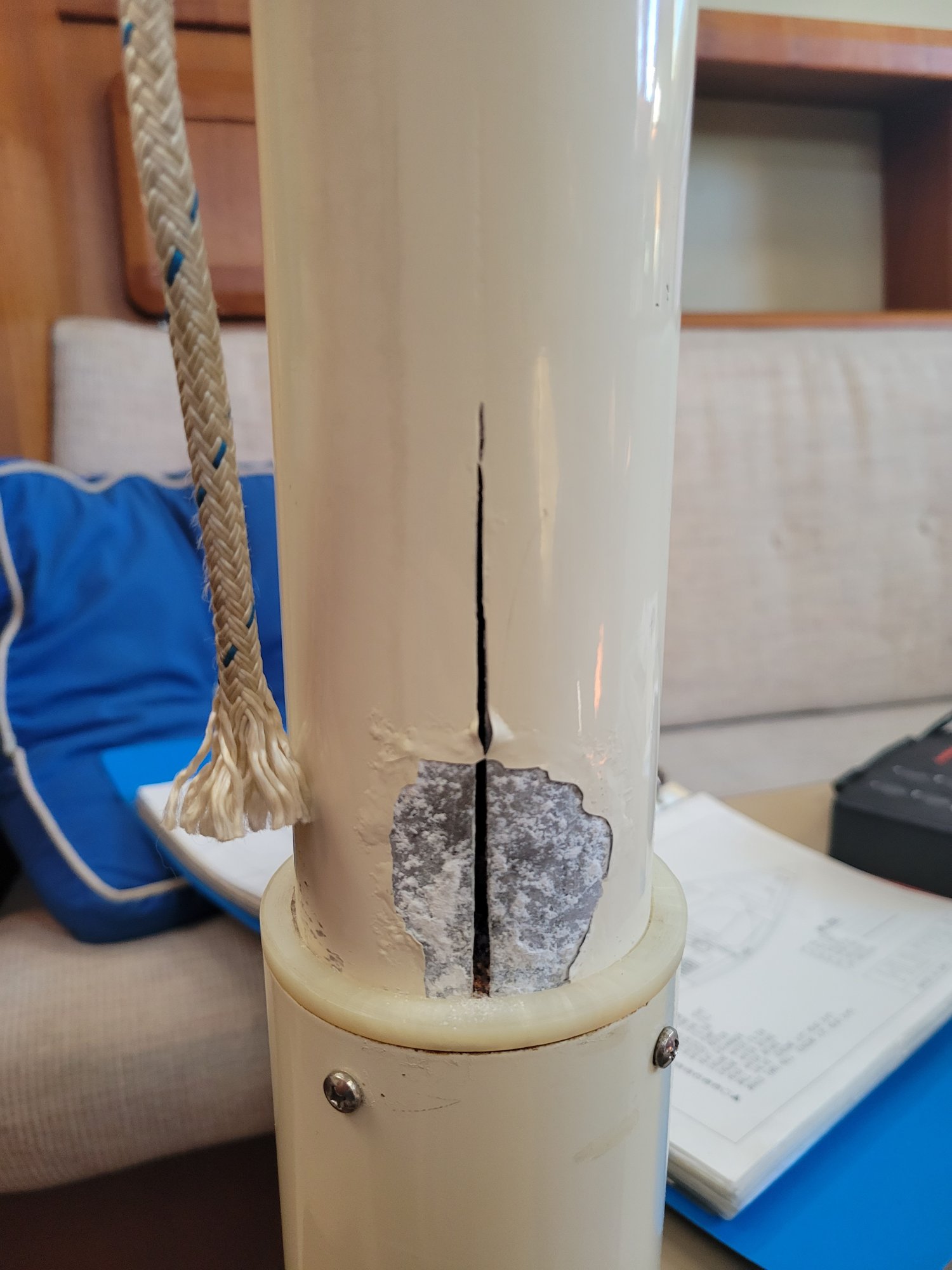

crack/cut in compression post H30

Hey sailors, anyone seen this on a hunter's compression post? it's a 1991 Hunter 30 I'm considering buying for my sailing school. I think the post still has plenty of support considering the entire Cylinder. Any thoughts or advice?

Either replace it with a new one fabricated to the same specs as the existing post or possibly remove the post and have a collar or plate welded to area to isolate and strengthen the affected area. Concerned that if it is not addressed, the fracture will propagate furher.

Is it plume or is it torqued? It looks like significant corrosion damage to the inside then the post was torqued to one side causing the crack. I do not know this year of Hunter but my 78 had a failing compression post support in the bilge that allowed the compression post to torque and get out of plumb to the mast. I’d be very concerned with this issue and the price adjustment would reflect it in a big way. Mine was actually easy to fix but a lot of labor and mess.

I have a 1980 Hunter 33 and had to replace my compression post due to corrosion in the bilge. It is a doable project and not expensive. I found an exact replacement for the post at Metals Depot on line. They identified the post material as structural aluminum tubing and cut a piece to the exact length and shipped it to me in a cardboard tube. If I were you I would replace that post.

That crack is in a really bad place in the post. It really significantly reduces the ability of the post to take compression loads. That crack really compromises the structural moment of inertia (not mass moment) .. Such a compromise can cause a failure that gives no warning by gradual deformation. The best thing to do is, as Easy says, to replace the post. A piece of aluminum tube or pipe is going to be pretty cheap (around $130) and the replacement looks to be a pretty easy job. The bottom flange and top don't look too bad to replicate.

That looks bad. I would not trust it and I agree with Kloudie1 that if it fails, it could do so suddenly. Replacing an exposed compression post like that should be a comparatively easy project though. Factor the estimated repair cost into your offer or walk away.

I would be uncomfortable as your insurance agent if boats with the damage in the image were being leased to clients of Sail Monterey.
I suspect you know the answer. Perhaps a welder can make it serviceable. Perhaps a new compresssion post is needed. In nearby Watsonville you have a spar builder who could address the issue.

hey JSSailem, have we met? I agree with you, the boat pictured is not mine but a prospective purchase. I have worked with ballenger in the past but in this instance, I should be able to source a structural compression post on my own to replace this one with just like RoyS mentioned in his reply. I'm glad I got the insight from this group before I made an offer on the boat.
I will say, I've never seen anything like this in an aluminum post. what I was most curious about was if this was done on purpose to fit the sleeve for the table/bed. it looks less like a crack and more like a wedge that was cut in on purpose.

Makes me wonder if it was intentionally cut, Why?
