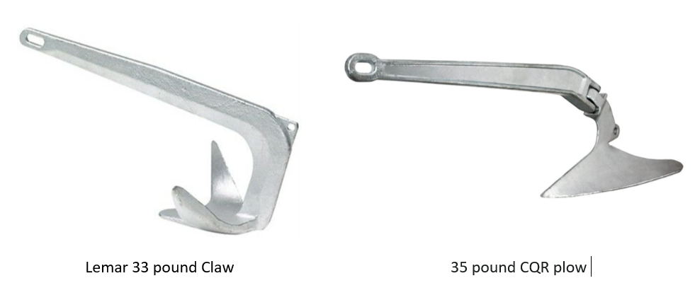

Hello all,
My B331 came with a Lewmar 33 pound claw (Bruce) anchor, which seems to work fine. I do have a 35 pound CQR plow (made in Scotland) from my previous boat. I would like to use the CQR as I have complete confidence in it.
Has anyone used this anchor? I am wondering whether it will strike the bow of the boat when on the roller.
The Bruce is fine, as shaped differently.
Any thoughts?
My B331 was made after they lengthened the roller somewhat.
Many thanks!

............My B331 came with a Lewmar 33 pound claw (Bruce) anchor, ............I do have a 35 pound CQR plow (made in Scotland) from my previous boat. I would like to use the CQR as I have complete confidence in it. Has anyone used this anchor? I am wondering whether it will strike the bow of the boat when on the roller. The Bruce is fine, as shaped differently. My B331 was made after they lengthened the roller somewhat.
Although I have not used a CQR anchor, as I have always used a Manson Supreme (25 lb on a Hunter 31, 35 lb on a Hunter 386 and now 60 lb on a Hunter 46). The CQR plow anchor is very common anchor in our marina. From the photos below I would not expect the CQR anchor to strike the bow of the boat, especially since you the you have an extended anchor roller. I know it is a hassle, but it would be easy enough to replace the anchors and pull her up to see how the CQR fits on your anchor roller.

Based on the picture sent by SFBay check out how much anchor can move on the hinge. I'm still using the original Bruce. The only issue I had was during a squall when the wind changed 180 degrees on a mucky bottom. The original chain was only about 20', I now have ~ 40'

I have a 35 pound lewmar plow anchor stored on the factory bow roller of my 323. Tip of the plow comes close but doesn’t touch the bow. Good anchor in sand, worthless like anything else in a weedy bottom. Qualifier: I don’t anchor out much.

Thanks DougM. There is a B323 next to me in the yard and I'll have a look.
I can take the Bruce off and hitch up the CQR, but it's a lot of work and I thought I'd get some opinions first.

I just saw 8 boats close by with CQR anchors and no fouling of the boat. Suggest deploying your existing anchor in your skip, move the chain aside, tie a rope to the CQR anchor and deploy over your bow roller, then pull it up onto the bow roller. If it does not foul the boat then you are good to swap anchors. Good luck and let us know the outcome.
