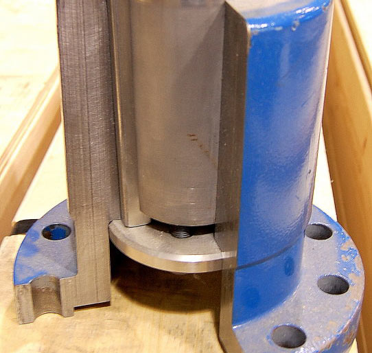

The coupling uses an interference fit - I used a split coupling which I was able to tap on with the coupling disconnected from the transmission. The transmission should not be the recipient of any hammer blows, even if cushioned by wood, you can damage the bearings. Read this article from MaineSail before proceeding:

I used a split coupling for the ease of removal. Except the shaft hole was .007 inch off center from the flange bolt pattern. That lack of concentricity caused my cutless bearing to fail because of the shaft wobble. Then it wobbled so much that the cutless became loose in the strut even with setscrews resulting in it spinning and enlarging the bore. I didn't have time to replace the strut at that time so I bonded the new cutless in with 5200. After about 12 hours the rubber insert inside the cutless broke its bond to the bronze sleeve and extruded out. We lost an entire season of sailing and had to haul again. The best thing to do if you go that route is to have a machine shop fit and face the coupling and check the runout. You want to make sure it is perfectly aligned.

The split coupling did not cause any alignment issues - it's not split in two pieces but is split along half its length. You should definitely have it fit and faced before installing.

Definitely read the Mainesail article mentioned above. Now is the time to pull the shaft and have a new coupling fit and faced to it rather than find out you should have done that later. How's the cutless bearing, anyhow. Just call me the bearer of project creep...

The hardest part, getting the coupling off, is done. It's a good time to replace the bearing if it hasn't been done in a long while. You'll also find out if your shaft is straight when you fit and face it.
