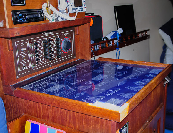

I'll second Stu's suggestion. We just did this on our '83 MkI nav station and salon table. Here's a link to my website with some pics of the nav station. http://www.mrlew.com/SV-Trinity/Bar-Top-Epoxy-Upgrades
The admiral did the lion's share of work. It is simply cloth fabric, purchased from Joanns Fabrics, covered with MAS bar top epoxy. We are very happy with the results.

That was a liquid epoxy? It looks like glass! Did you just pour it on? How did you keep the hinge from getting epoxied? Did you just use the outside trim as a dam? How mush did it take for the Nav Station and the Galley Counter?

What I can tell you; yes, it is MAS Table Top Epoxy and fairly easy to work with. As with any epoxy project you need to plan ahead and be ready for anything. Once it is mixed the clock is ticking. We learned that proper, thorough, mixing is critical, don’t worry about creating air bubbles, they will dissipate. A heat gun is a must have as it helps remove those air bubbles.
We removed the hinge; actually we removed the whole table and did this in the garage at home. The trim on 3 sides acted like a dam and we used duct tape to hold cardboard in place as a dam on the fourth side. That edge did require some light sanding after curing.
The final result isn’t perfect, dust and tiny bugs I never knew existed in our garage are your enemies, but, we think, it looks FAR better than the fake wood grain contact paper that it replaced. And, as with many things, the minor imperfections are probably only obvious to us.
We did not do the galley counter as it still looks "okay" (sort of)
We did do the salon table and that was a whole other, larger, project as we cut it down to make it a more manageable and usable size for us. I replaced all the railing trim as well. If anyone is interested I’ll try to find, or take this weekend, a photo of that too. If I recall correctly the table took a 1/2 gallon kit for a 1/16" coating.

That was, in fact, MAS Tabletop Epoxy. And it did come out looking like glass. The teak trim acted as the dam on three sides. The fourth side was taped with masking tape and then backed up with cardboard stapled into the end just to add some firmness to the tape after the hinge was removed. The epoxy is a 1:1 mix ratio and this piece took 12 oz of epoxy and 12 oz of hardener.
We did not do our countertop, but did do our bulkhead mounted salon table. That piece took a full "kit" (small) of the epoxy. I think that was 1 qt epoxy and 1 qt hardener. The epoxy finish on both ended up being a tad over 1/8 of an inch.
