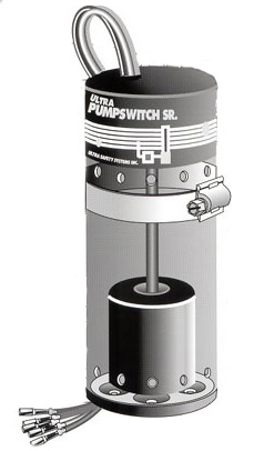

Five years was pretty true back when mercury switches were used, today it is more like a few weeks to a few months....:wink: The only switches I install these days are the ones made by Ultra Safety Systems. I know a lot of people recommend the Water Witch but I have had quite a few issues with those switches. The best bilge switch, the one I have & use on my own boat, was unfortunately discontinued because NO ONE was willing to pay for the quality.
If boaters continue to demand cheap crap, they will continue to get cheap crap. IMHO none of the centrifugal pumps are worth the packaging material they ship in. I am glad I bought a spare for my bilge switch because I might need it in oh, 30 years..... :biggrin:My savings on bilge switches will continue to fund a new centrifugal pump every 1-2 years...
BTW my last diaphragm pump was from 1982 and was still going strong when I replaced it. It was just getting a bit rusty so I yanked it, but it was still purring along beautifully and pumping water like crazy. The boat has had no less than a dozen centrifugal pumps in that same 31 year time frame.
