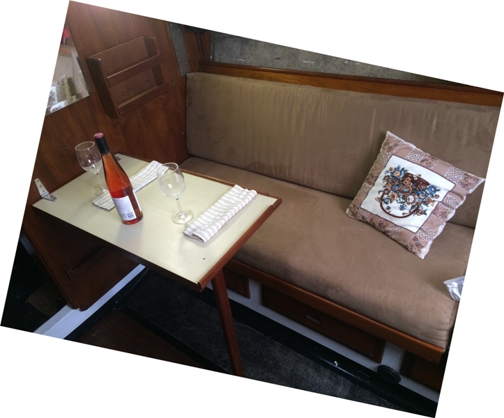

cushions.JPG Another DIY fan. We did our own on our old SanJuan 28. What a difference.
As for a pattern: the old upholstery is your pattern. It's really pretty simple.
