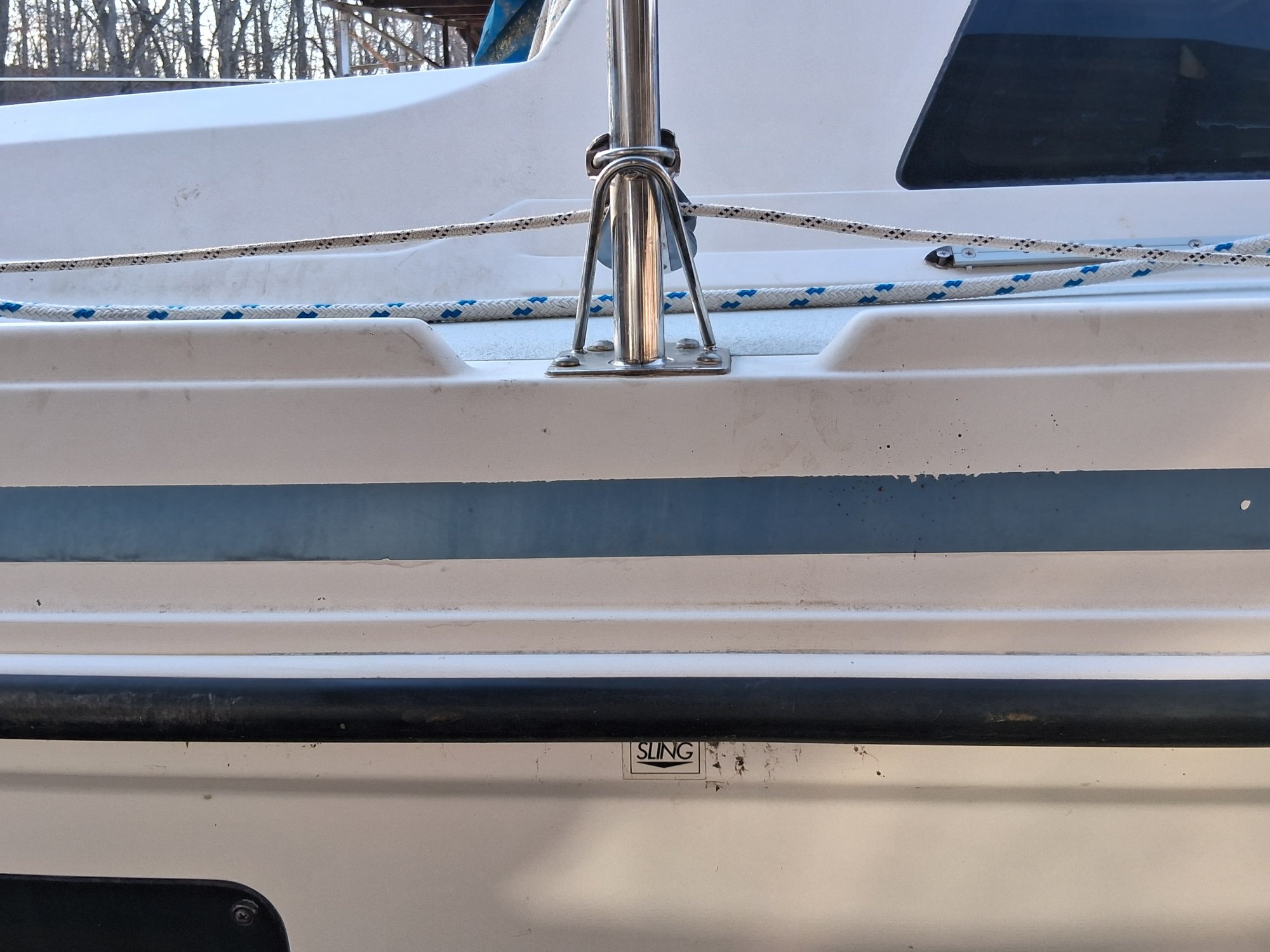

Mine has marks for slings for hauling out. I would guess they would be in about the right spot for a cradle as well. If yours is lacking these marks, I will take pictures and show you the location

Those strap marks were installed by Hunter. Please take pictures and measurements and post them here. In addition can you please post this information under Hunter boat information. Thank you.
@ColdSophie
If you do get a photo and measurements please advise. If not, call Al at the forum parts forum and he can advise. They have a copy off your build list of parts and are former Hunter employees. They do their best effort to help you
Hello Thanks for the pics. From a Hunter 27-2 (89-94) ?
