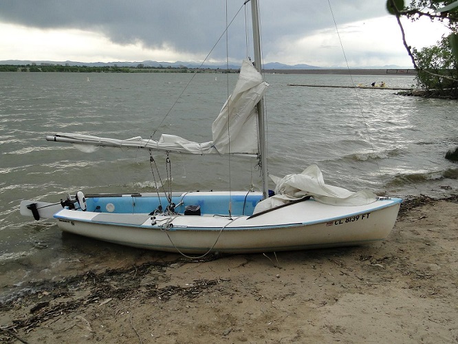

And be a little cautious, its intended as a two person racing boat. It will capsize. I picked one up not knowing much about it for single handing and thought it sailed great until experiencing higher gusty winds (higher elevation sailing). Capsized the boat and did not have the access hatch secured, hull filled with water and turtled. Once the hull is full of water, it looses all stability and has no righting moment. If you sail it much, you will capsize it so at the min, keep that hatch sealed and get the boat back upright as fast as possible (easy to do by standing on the centerboard). Later I watched someone trying to upright a C15 that had water in the hull.. guy wore himself out trying to do so with the boat just flopping from one side to the other. A power boat towed the C15 back in on its side and busted the mast doing so. Being in my later 50's when I was sailing that boat, I also put a float at the top - which of course will be scoffed at by the racing folks but would have gotten rid of that boat without the float. With the float, capsizes were not a big deal and I sure had a lot of fun sailing it for a few years. I would capsize it at least several times per season (Colorado - gusty winds). Young folks can just get the boat back up quickly so dont need the mast float.
