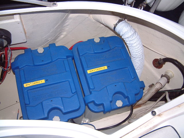

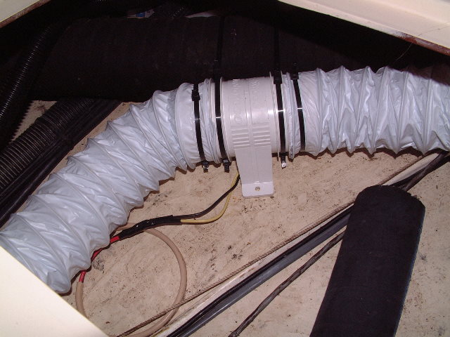

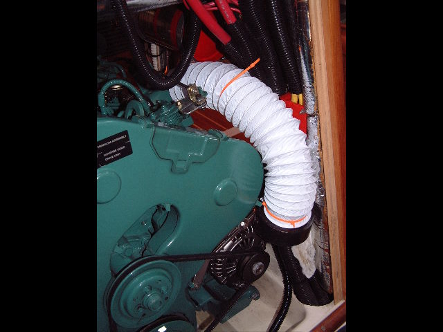

AGM batteries have been getting alot of press in the forms over the last few years. Shore charging, regulator settings, batteries getting less than a full charge. What I saw in reading many of the threads was exceptional info of real life experiences dealing with the pursuit of a full charge in the short time a sailboat is running its engine. One point that has been mentioned has been the high temperature that alternators can get to when charging AGM batteries. I did not find many remedies other than opening a hatch to allow for more air flow to the alternator and regulator. I too have been thinking of this issue as I became disenchanted with the 4 1/2 years of life with my two golf cart lifelines connected as a house bank. With a little testing I found that my balmar 80A alternator was hitting 230° F, IR temp meter. I have been pursuing adding ventilation to blow cool outside air directly on the alternator. There have been several issues that have come up such as: water seperation, air for the engine, air balancing with exhausting air, and power robbed from charging to run blowers and controllers.

Adding ventilation

My corrective action was to buy and install a new extinguisher and located it near the rear of the engine compartment so that the alternator was not directly underneath it. I also installed an alternator temp sensor and wired that to my external alternator controller. Additionally I ran a 3" vent from directly above the alternator and sucked the hot air out of the engine compartment with an in-line blower. I used an existing cabin ventilation port in my stern near my batteries to vent the hot air.
I had found that my alternator was running at 230F when it was producing about 70A before I installed the temp sensor. With the temp sensor and the ventilation the alternator is dialed back and the case temp now runs about 170F. The compartment temperature doesn't rise above 135F so the extinguisher which triggers at 175F should not go off.
