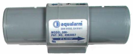

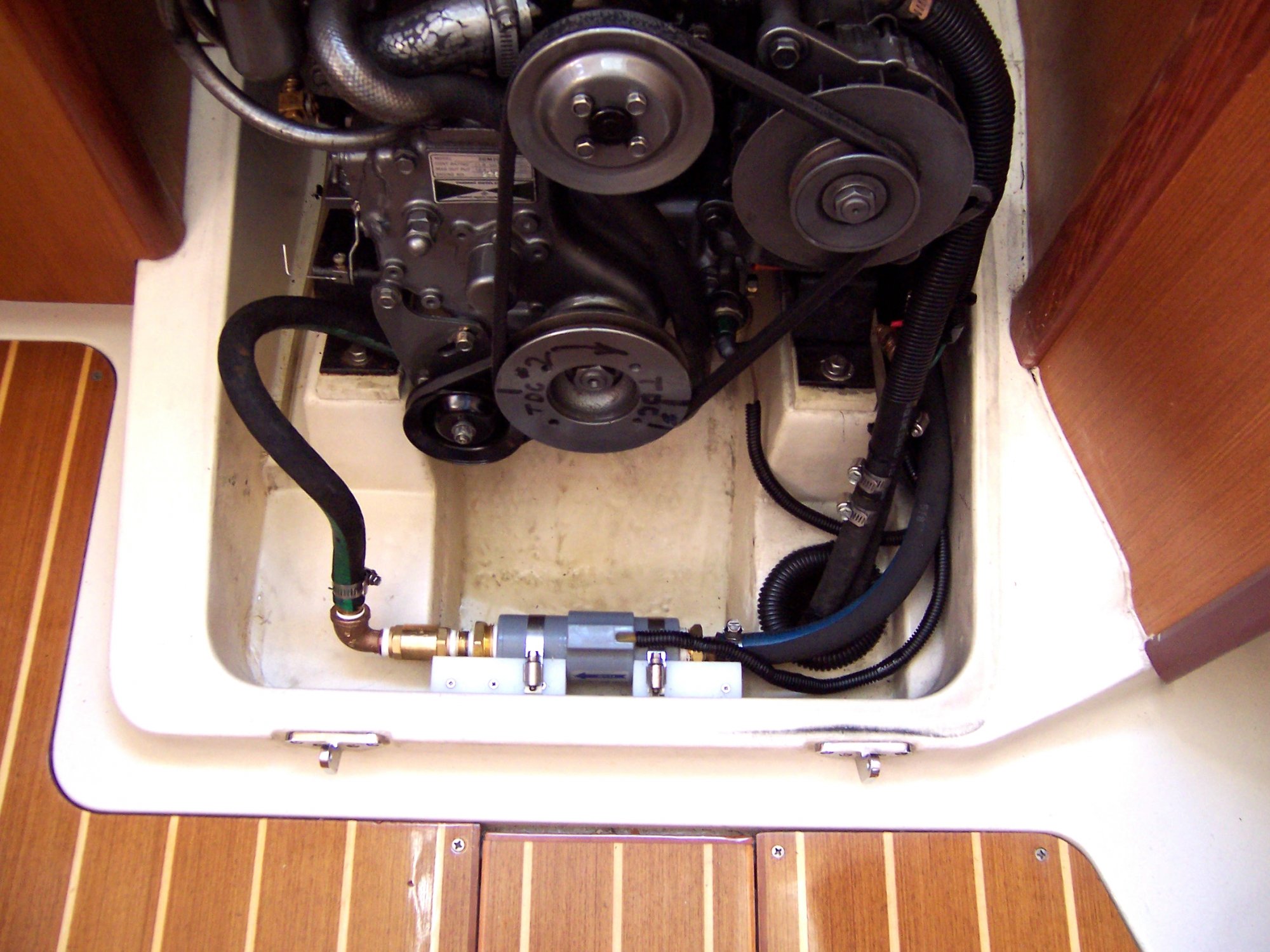

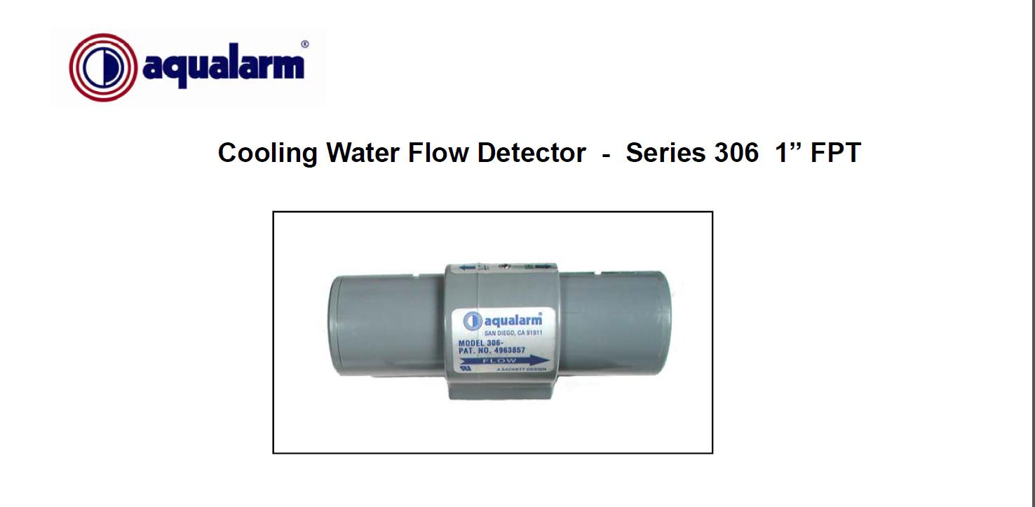

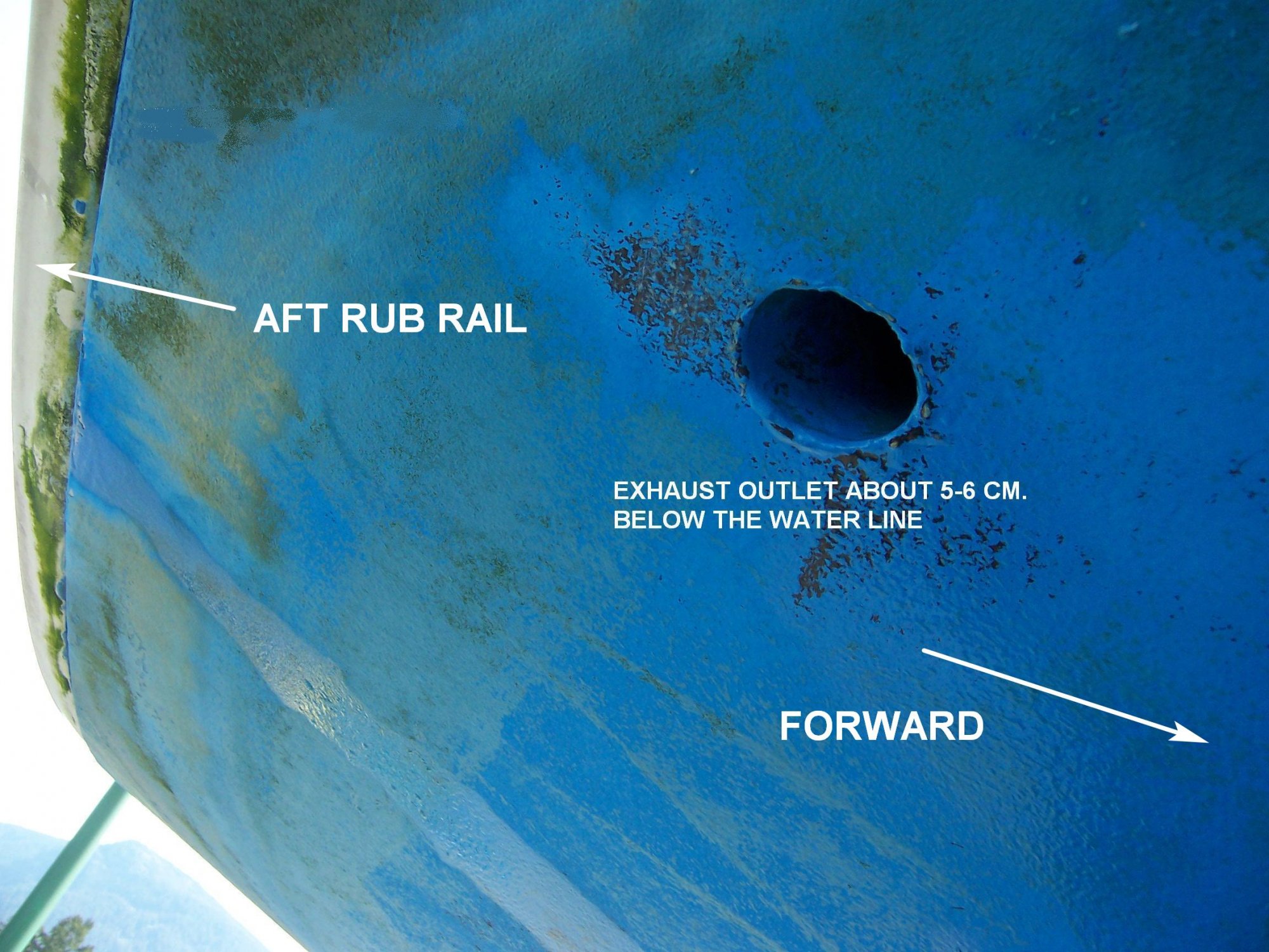

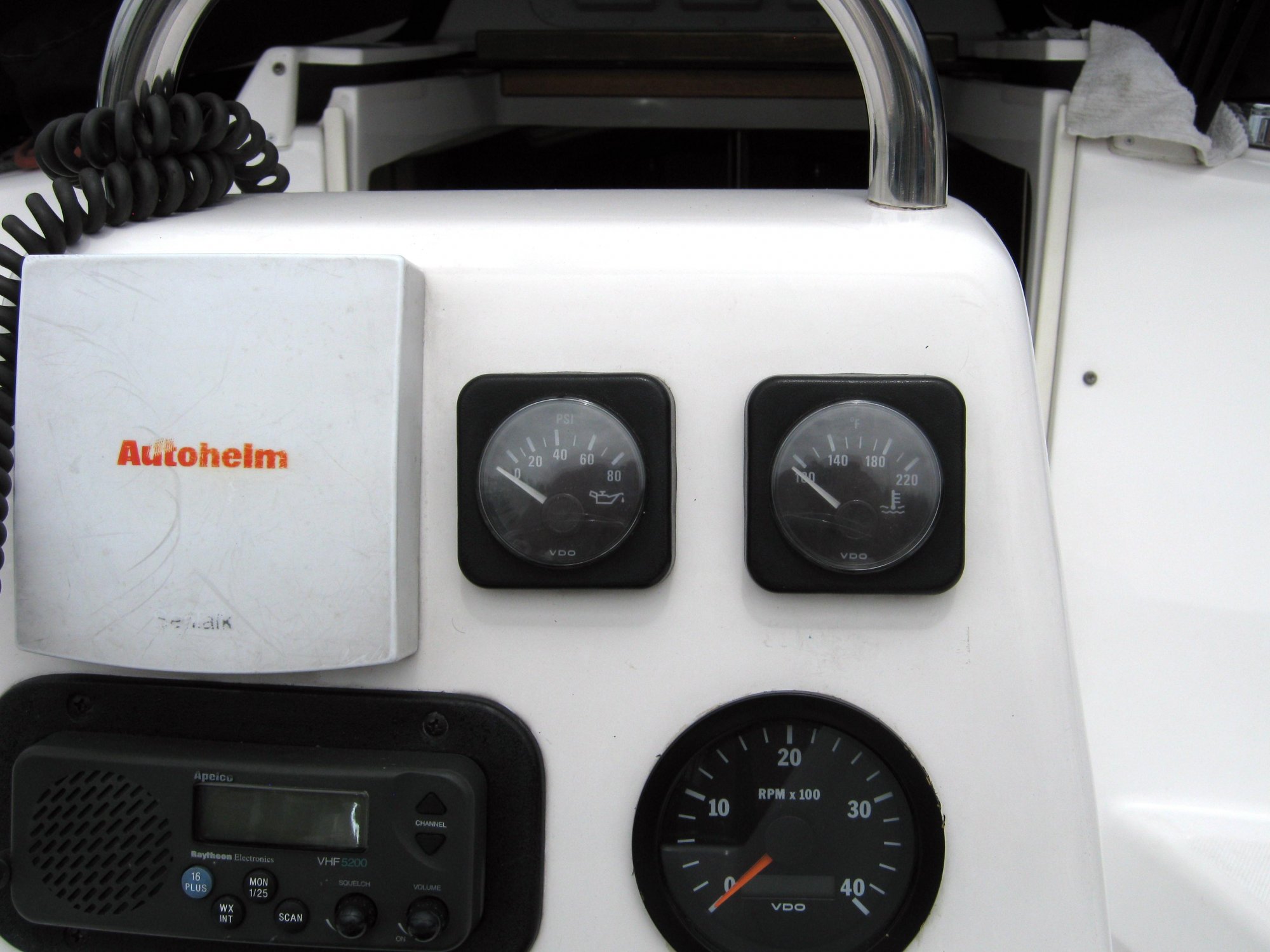

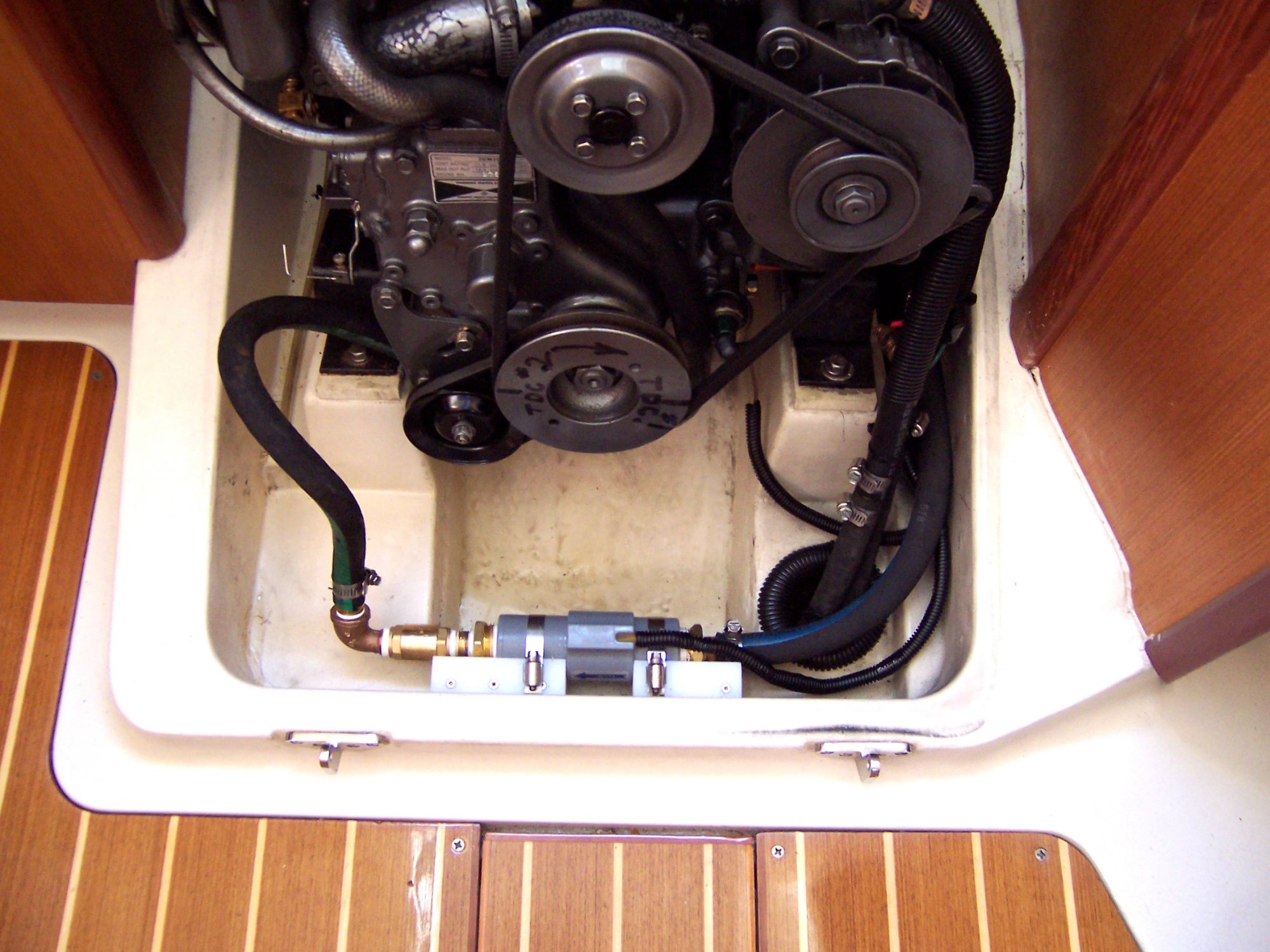

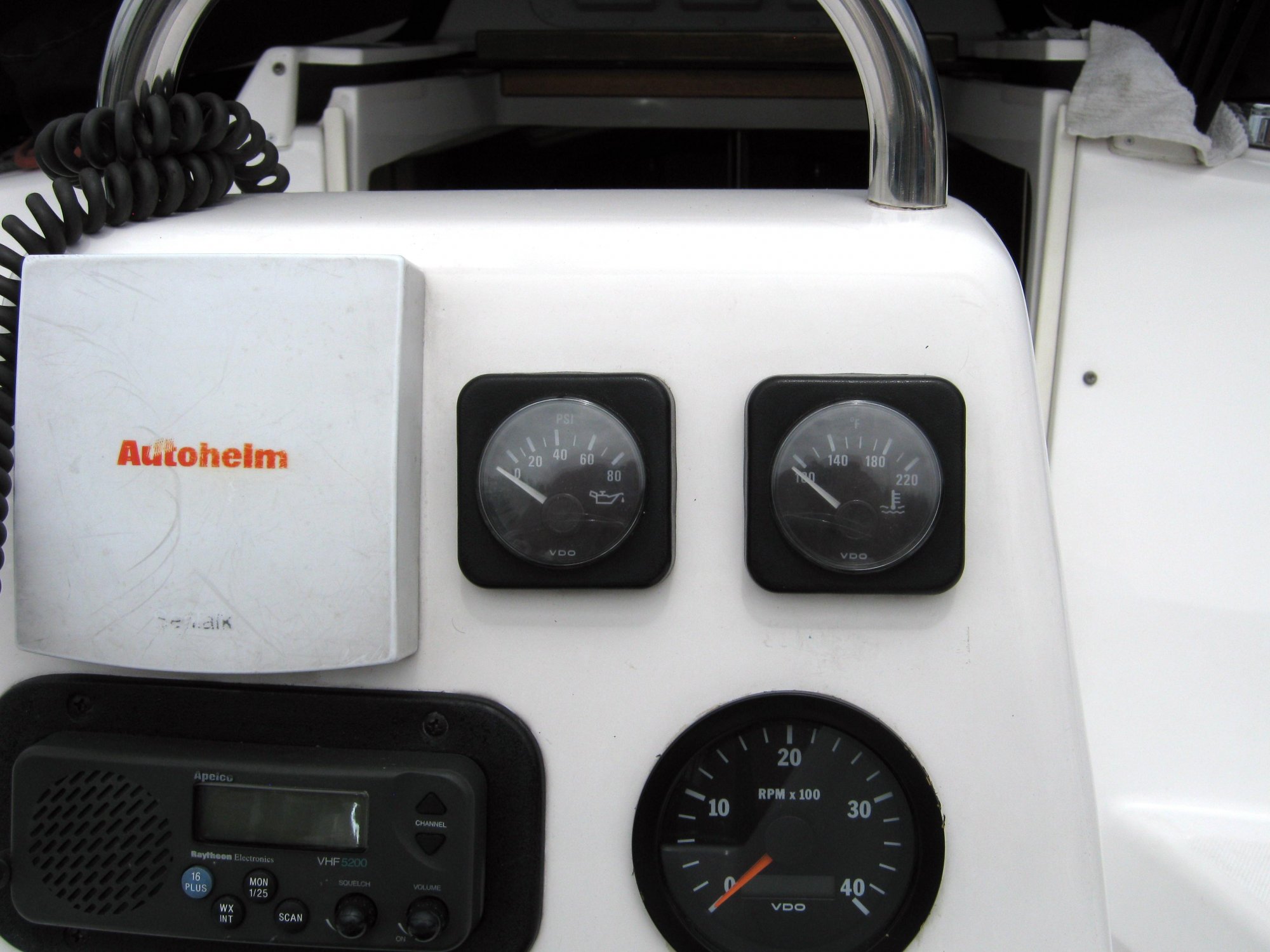

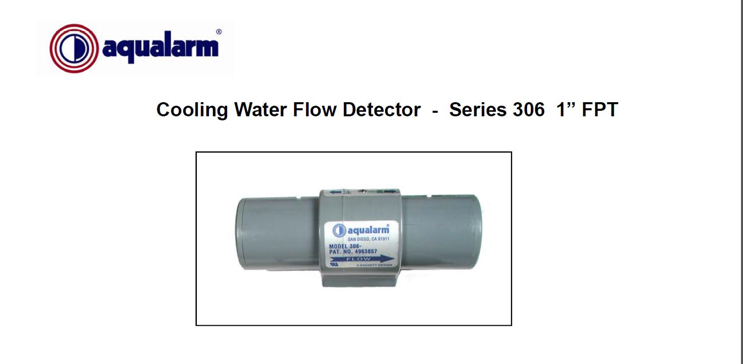

Hunters are a bugger with the underwater exhaust because you simply cannot tell if cooling water is being expelled to the exhaust. Don't ask me why, but two weeks into owning my brand new 1999 Hunter, I installed a sea water flow alarm and an engine temperature readout gauge.
Have I thoroughly scared you ? ? ? Good, chances are you won't become one of the ever increasing CO poisoning victims which are becoming more and more common every year.

I'm guessing that if your exhaust is below the waterline even at rest, it will be difficult to recognize if the turbulence beneath the water is a combination of water and gas, or just gas. The sound of exhaust is usually the clue that I most carefully observe. In my case, when I'm sitting at the dock, I can see and hear the water spitting out above the water surface, but as soon as I am underway, I can't really see it as the boat squats just enough to submerge the exhaust. That is when the sound is most critical to me.
