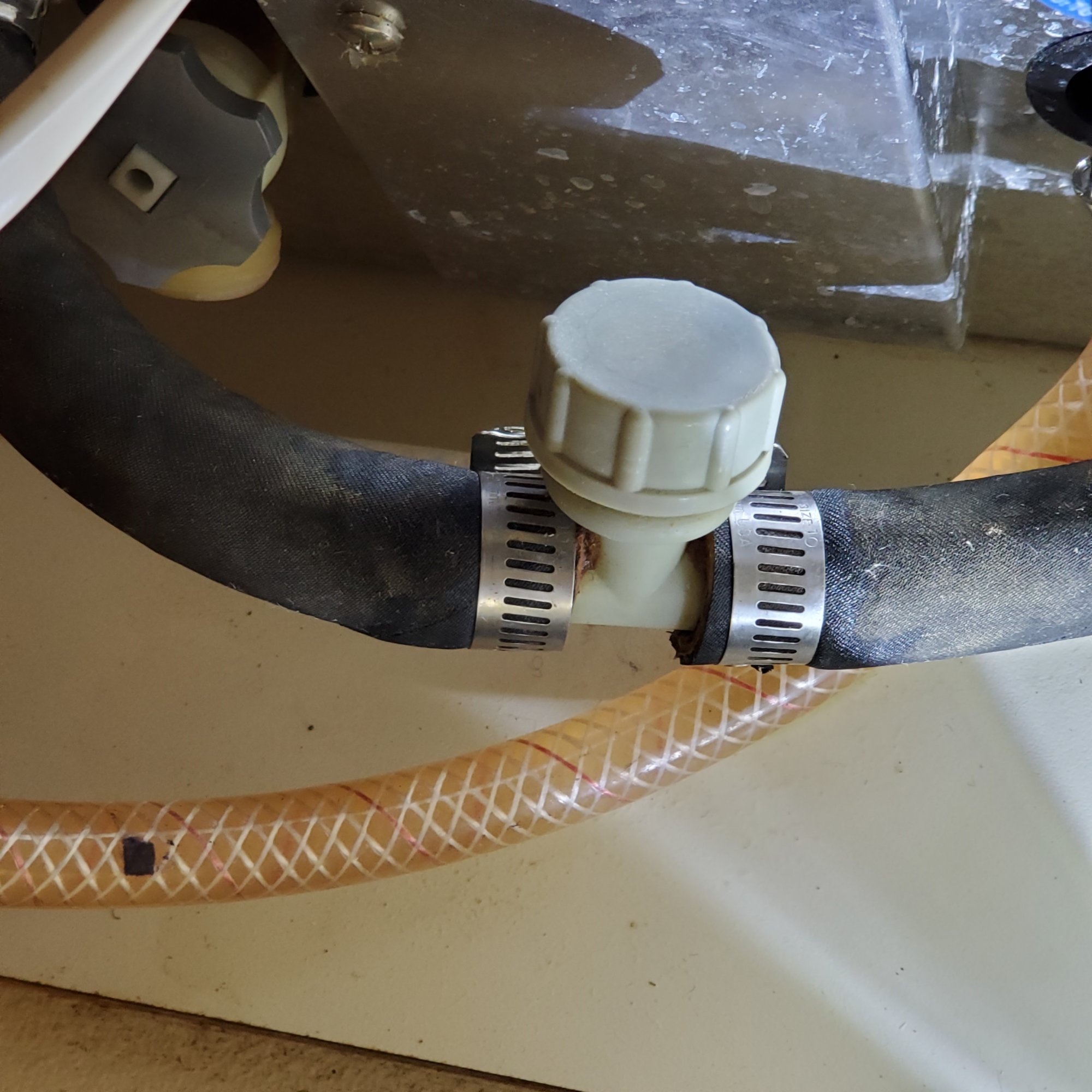

Do you have one (maybe 2) of this type of fitting anywhere along the heater water lines? My 3GM30F has 2. One at the top of the engine and another near the water heater input hose behind the heater itself.
This would be your flush out connectors to do what you are asking.
They allow you to attach a garden hose to flush the system and only remove one hose to allow the flush out to be drained into bucket.
That’s how I did mine a while back.

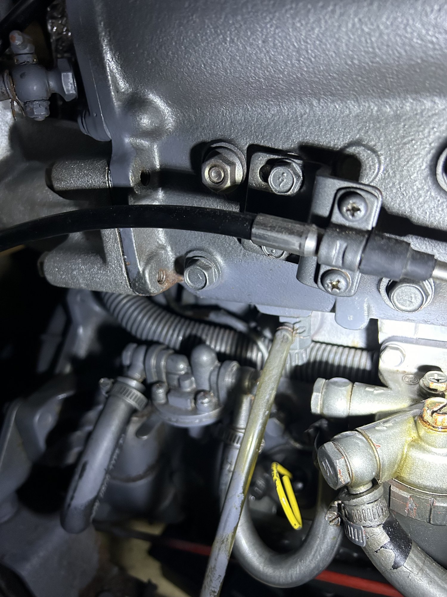

Also, on either side of the engine are small petcocks. They may or may not have a clear pvc hose attached to them. The engine heat causes them to dry rot and fall away, but the petcocks are there.
Spray them with a little PB Blaster or the like to make certain they are free before just trying to open them. If nothing comes out after opening them up, use a thin wire to scrap around the opening to free any crusted up gunk inside the opening. These allow you to fully drain out the antifreeze.
Just add a length of tubing to each so you can drain each side into a soda bottle.

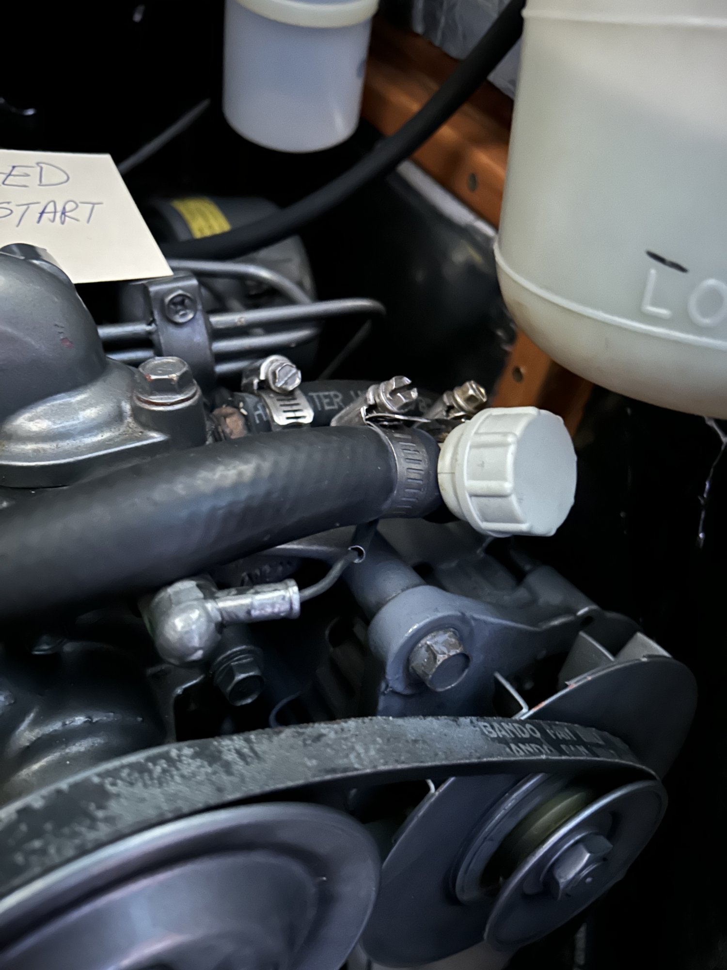

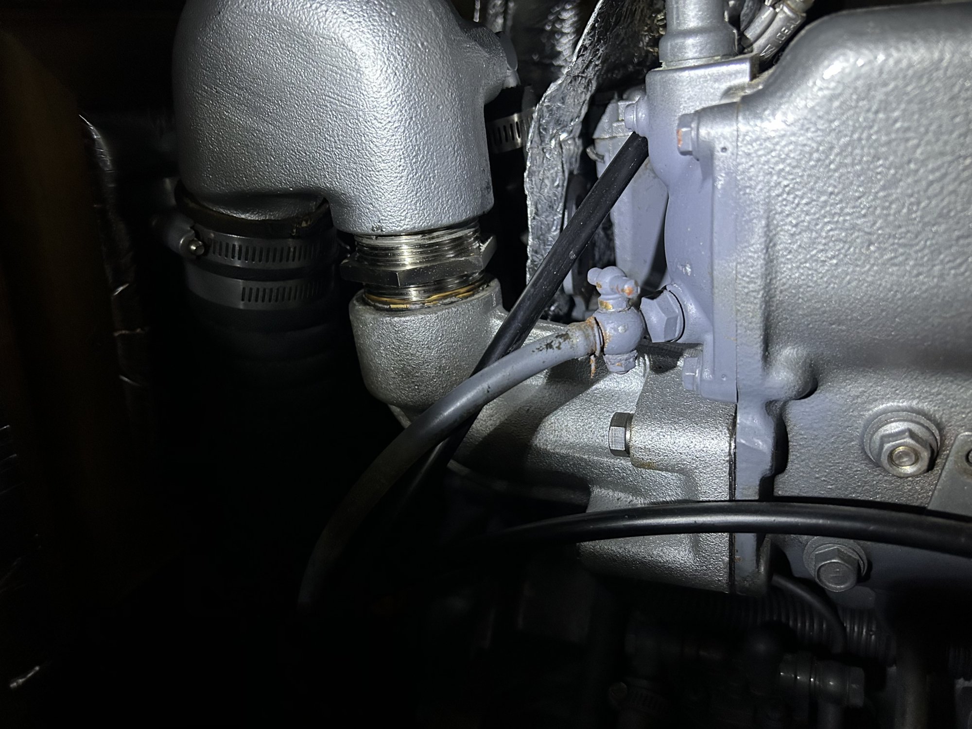

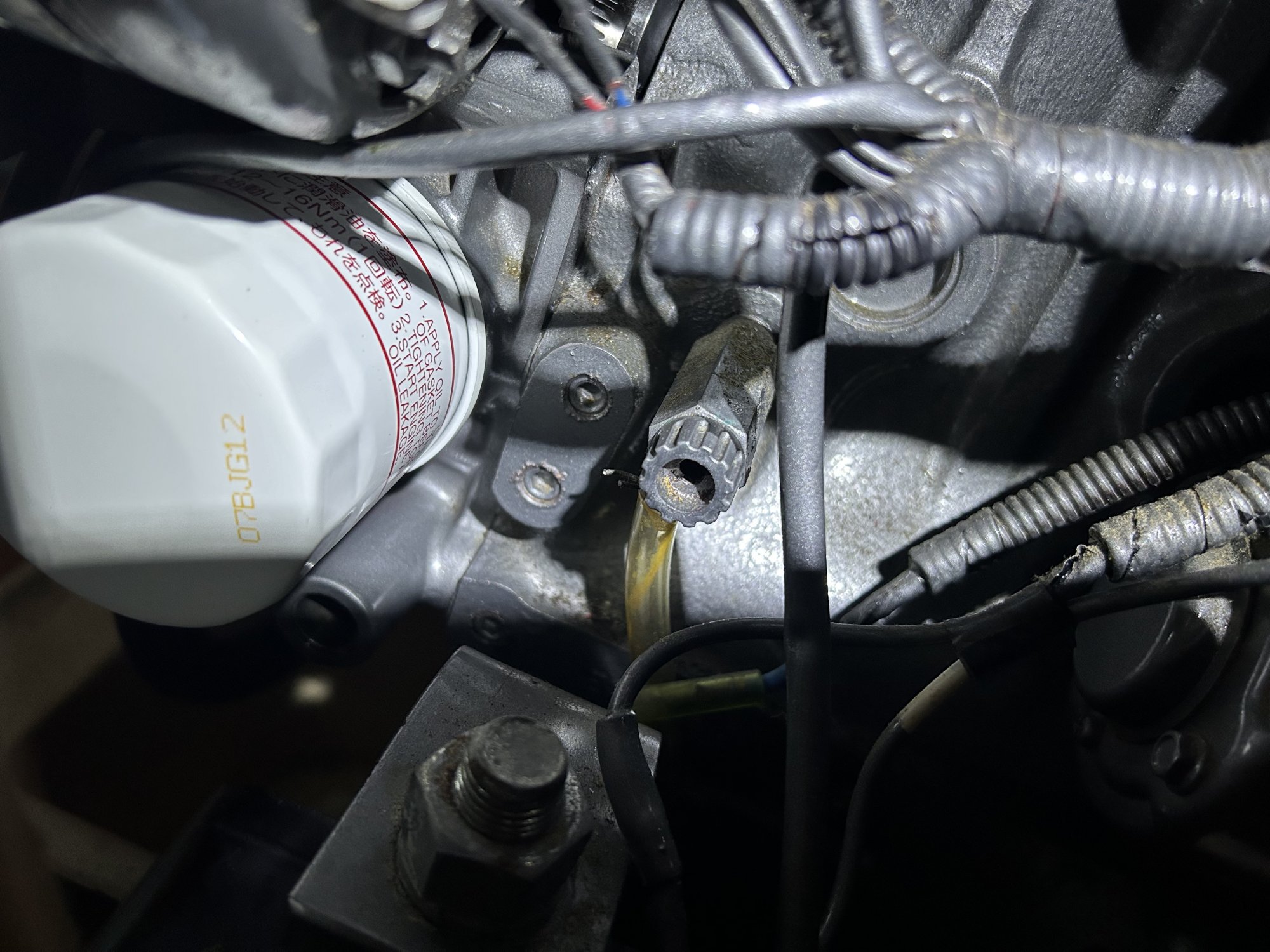

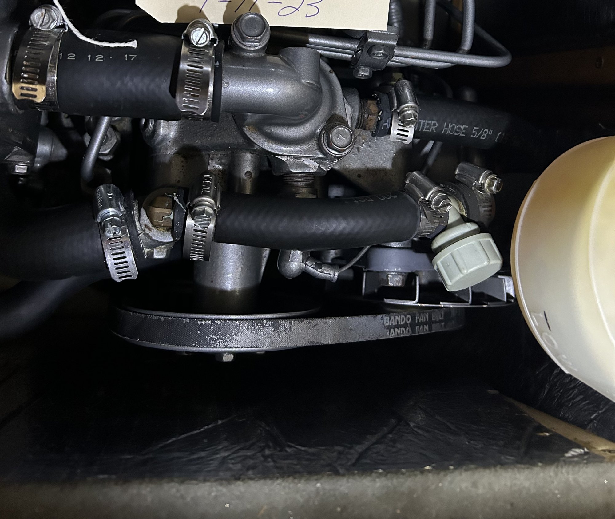

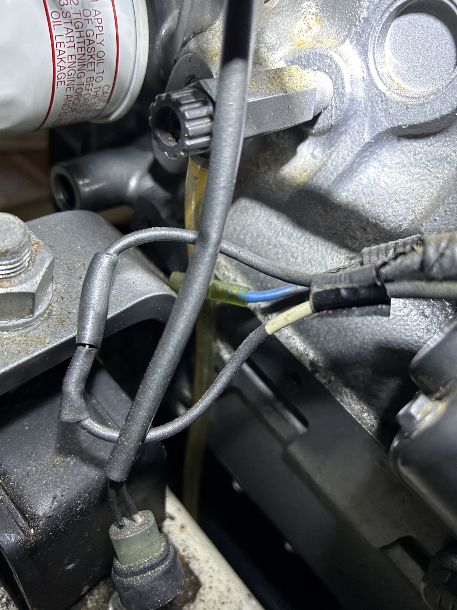

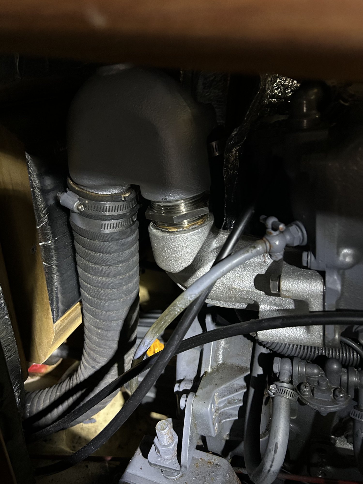

While I was on my boat this morning I took photos of the various fittings you should find on your 3GM30F to drain coolant.
Photos help a lot more than just words.

Thank you all for your responses. After some searching, I decided to just drain, refill, run and repeat twice more to make sure I got all the old coolant out. With the exception of the of the drain by the lift pump (which was mounted vertically) they were all very easy to get to and made the job pretty easy. I was able to pull the hoses off the water heater and just let them drain down into rags. Took a while since I had had to let the engine cool between flushes.
