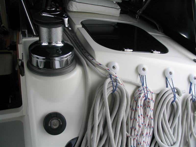

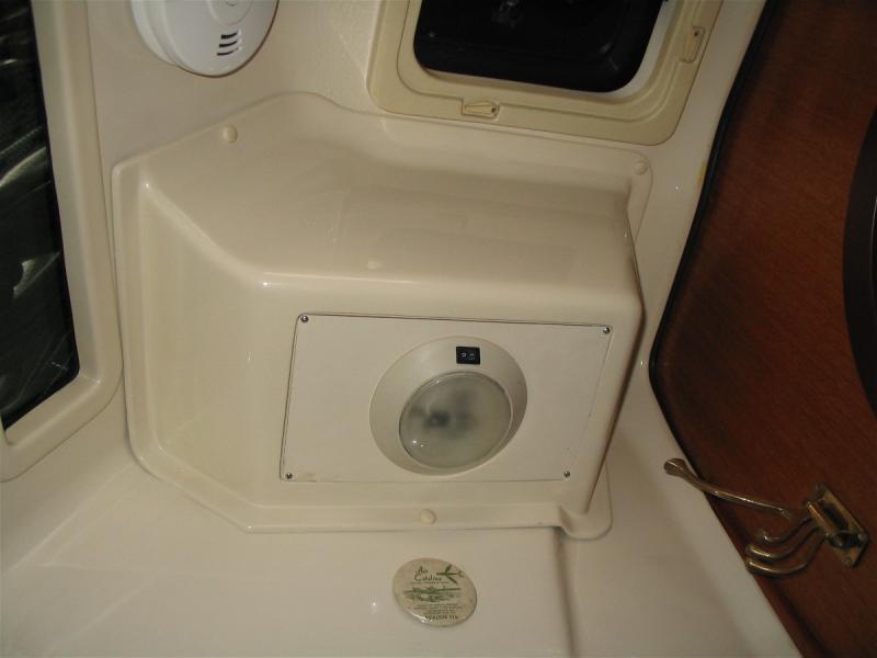

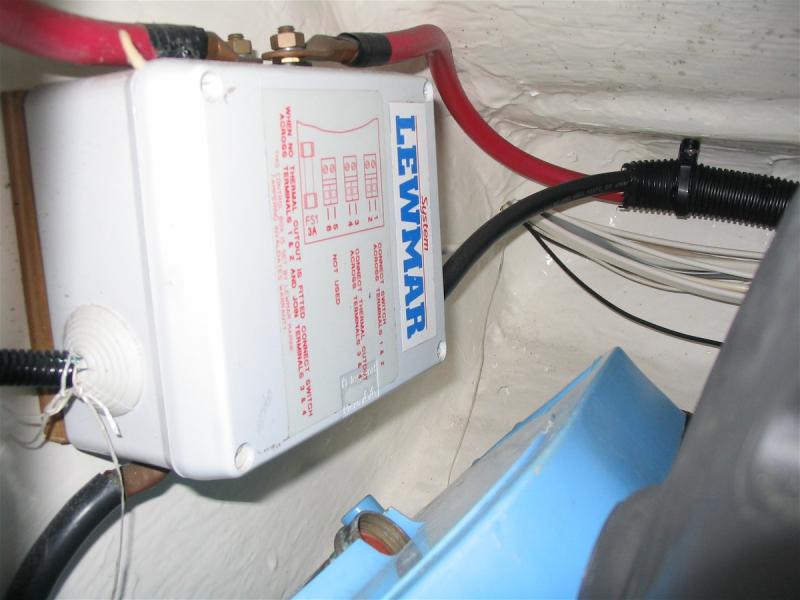

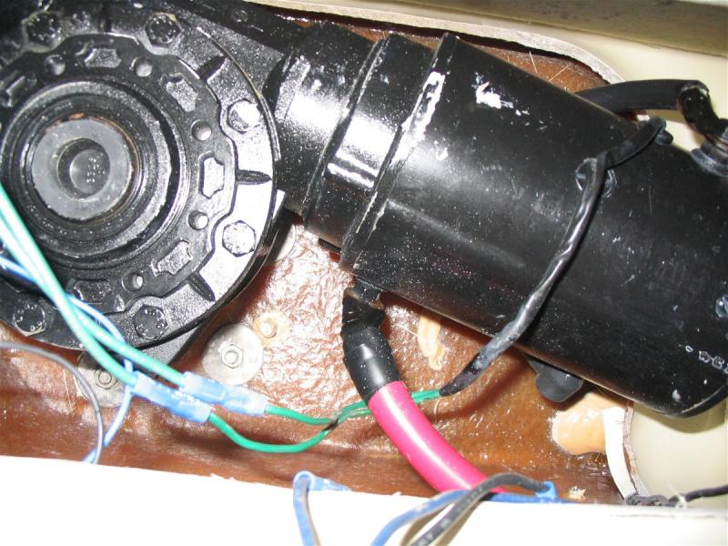

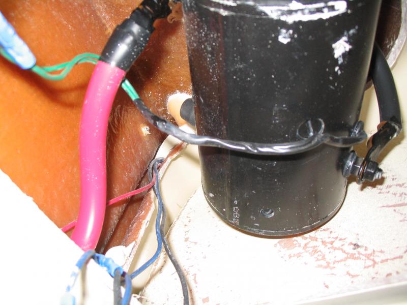

Here are some photos
I *think* the power cable runs down in the same space between the inner head panel and companionway panel that the fuel shut off does. The relay is on the forward side of the starboard cockpit locker. As Don noted, the wire sizing is critical and the run should be aft to the house batteries (via the 3 way switch).
