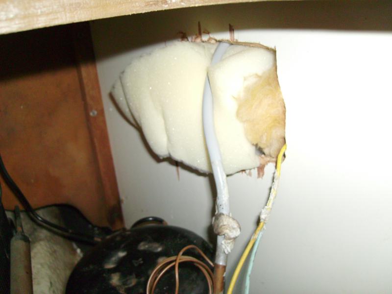

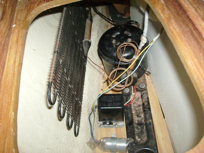

I disassembled a dorm fridge, cut a hole to pass the evaporator through the STBD icebox wall from the trash bin space, mounted the compressor and condenser in the space with the evaporator in the icebox, but I had messed up the equipment with the install and need another "donor" fridge.
