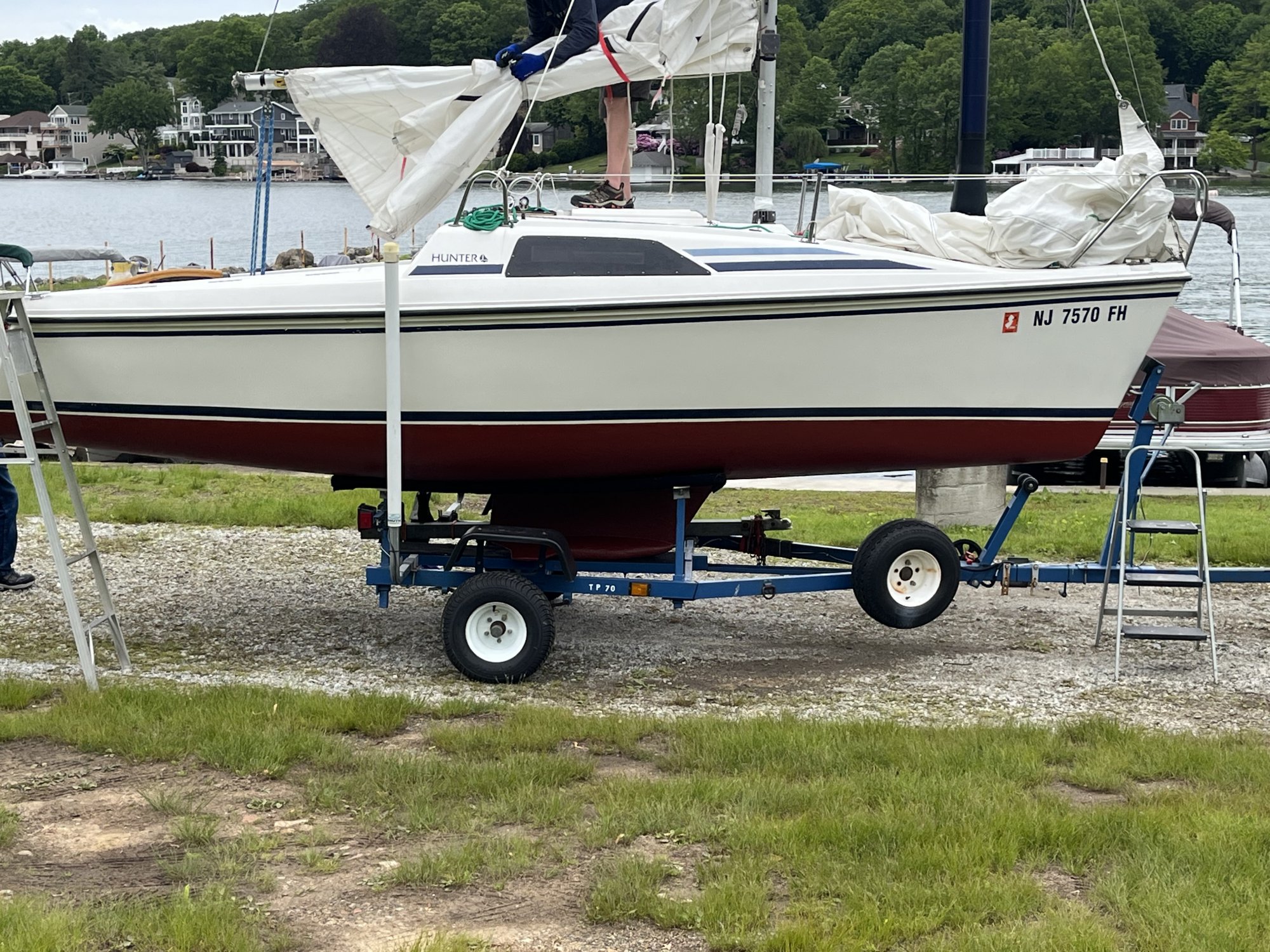

Just wondering if this is a worthwhile pursuit. I’m thinking of using a 4 in drop axle on my trailer for my Hunter 18.5. By lowering the trailer 4 in it would be helpful while setting up & rigging. Also easier to launch & retrieve. The clearance now is about 14 in from the frame to the ground so I should have plenty of clearance even if the trailer is lowered. Has anyone done this? Other than some $$ for the axle and some hours of work don’t see much downside. Thoughts?

In the photo, it looks to me like you might be a bit tight on ground clearance, but that could just be the perspective. So long as you're happy with the ground clearance I think it's a great idea. For a 9 degree ramp, getting the waterline 4" closer to the ground means the tow vehicle is about 25" further up the ramp when the boat floats off. Lowering the center of mass will improve stability, too, at least in theory. You might want to also lower your hitch ball so that the frame rails remain close to horizontal.

I can't see what you expect to gain by lowering the boat 4 inches while on the trailer. Have you considered platform shoes or stilts? Just going by the photo the biggest problem getting hull closer to ground is more one of depth of keel than wheel axle height. Nice boat bet it's fast:)

I wouldn't move the boat any further forward as the keel is already past the axle .
You want the axle to bear the weight ,not the trailer tongue .

Thanks for everyone’s input. The trailer is the factory Kenmetal trailer and the boat about as far forward as it will go. I am aware of scraping the bottom of the trailer when using steeper angled ramps but even when lowered I should have about 9 to 10 inches of clearance. Typically when retrieving the boat I have to use an add on extension to the trailer tongue in addition to the built in one that came originally with the trailer.
The ability to just use the built in extension with the lowered trailer is a tempting idea.

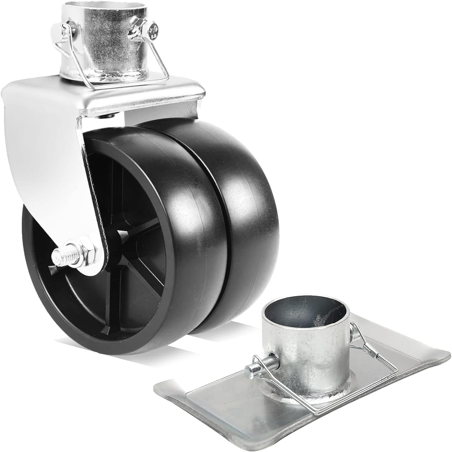

you could also use the kind with the interchangeable feet
You could also perhaps cut the wheel off and put one of the interchangeable feet on the jack. I did this on my utility trailer when the foot rusted through now, I have the option of a caster wheel or a plain flat foot.
Measure the diameter of the feet and jack post before cutting it would suck to find out yours is not compatible.
Like these:
