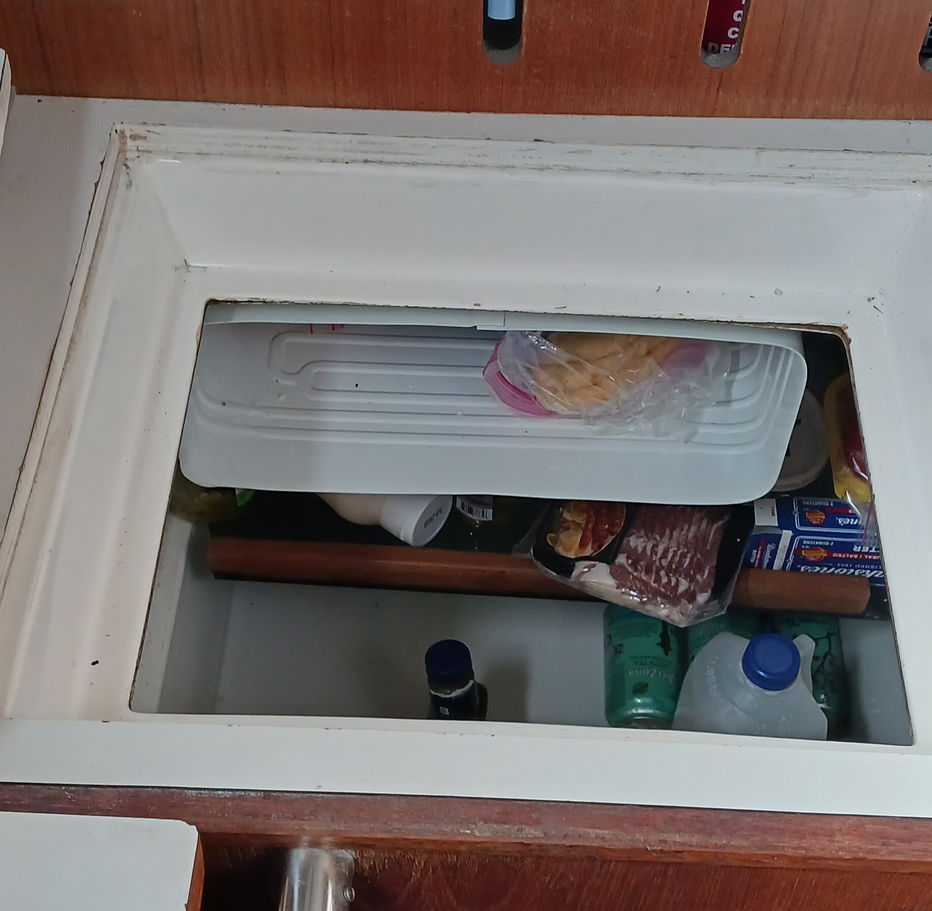

I have a 1985 Hunter H34 and want to convert the ice box to fridge, MAYBE. We are not live aboard, but have recently retired and will be doing multiple weeks at a time now. It is a 5 cubic foot box. was not thinking of freezer only cold storage for now. Does anyone have a suggestion for equipment? How many amps per day would be expected? Is there a better solution than converting? Any suggestions would be welcomed.

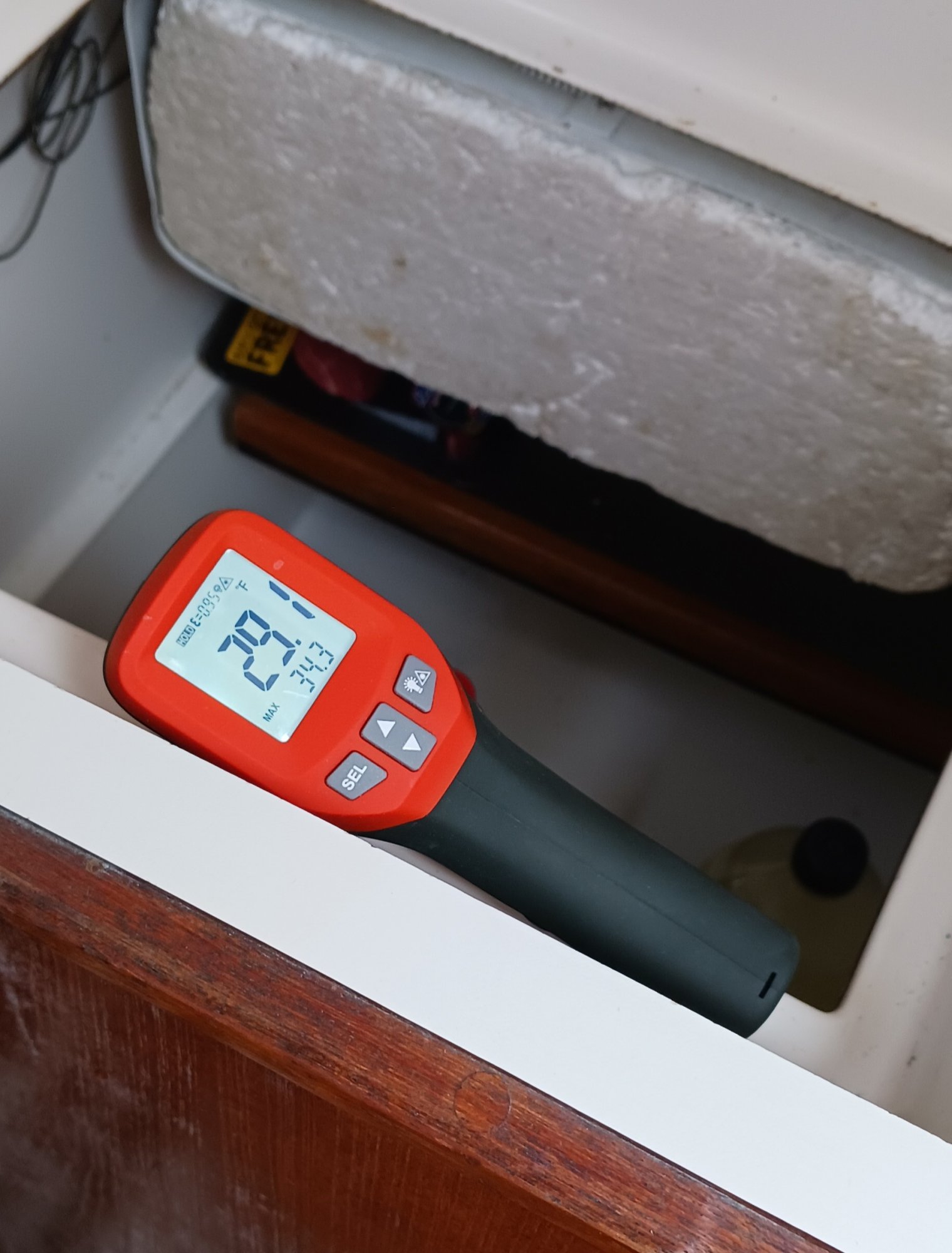

I have a hunter 34 apparently was converted quite some time ago it has an alder Barber cold machine probably running on R12 but I'm a retired HVAC business owner and know enough not to touch it until it actually breaks down, it consistently gives me 29° in the Box with semi Rock hard Frozen Goods inside the evaporator could go colder but I don't bother has a cute little styrofoam board sticking in the front like a little door so it works like a little freezer

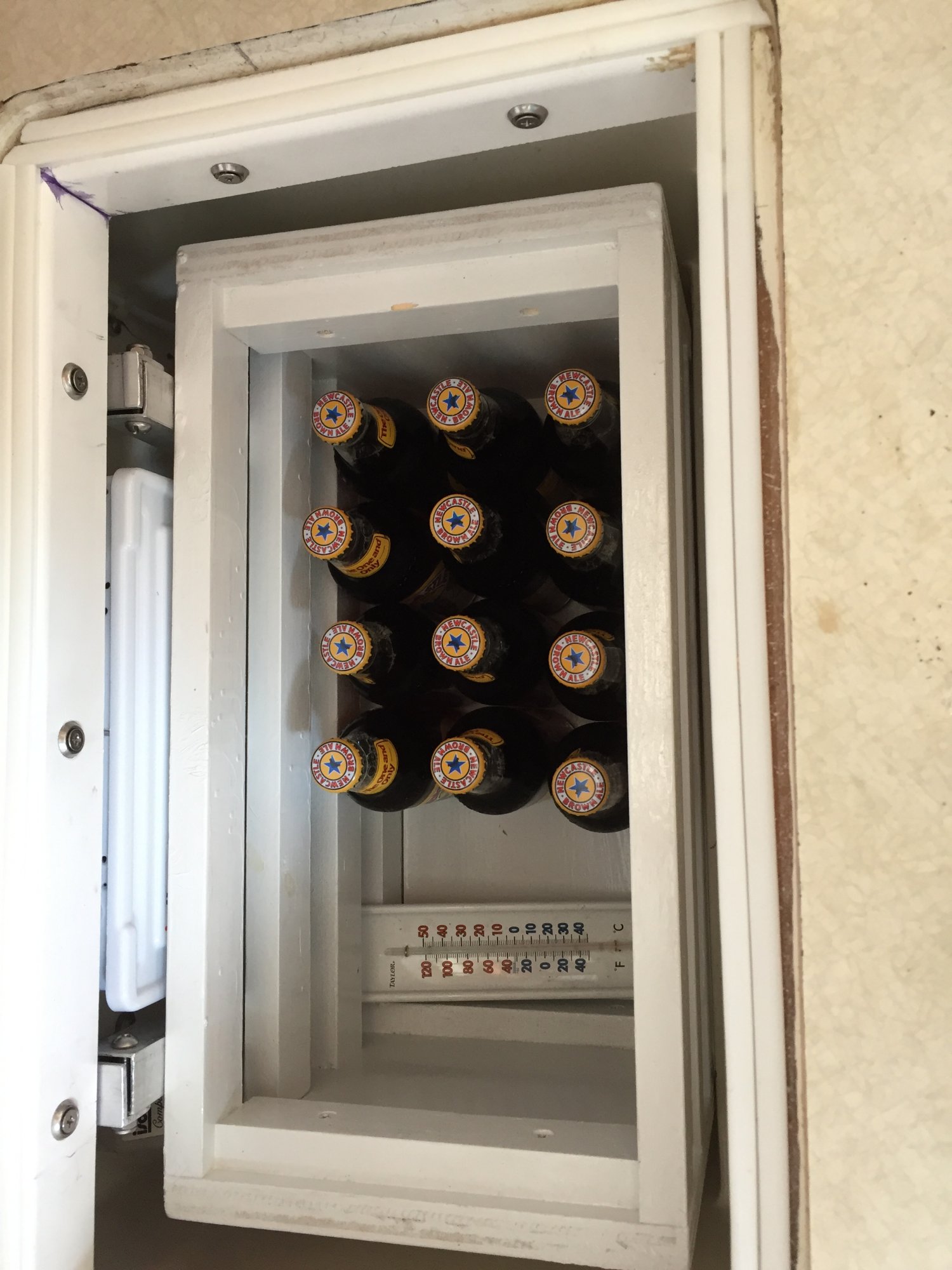

10,244
The box on the 34 has pretty good insulation.. Note the position of the evaporator box in Denise's installation..My box had been converted by the PO back in 1986 ish.. It was an F-12 water cooled unit from a company, Frost, in Florida and worked pretty well. The evaporator on mine had been placed vertically on the engine-side bulkhead and had little vertical ice cube trays inside.. The vibration from the engine eventually caused the trays to wear holes through the expanded aluminum evaporator. At that point, the unit was removed .. we were not cruising much because of jobs, raising kids etc so it never has been fixed/replaced.. The cost of replacing the evaporator box and conversion from F-12 is a significant % of the cost of a new unit, so I never bit that bullet.. My advise is to install the evaporator as in Denise's boat.. and think about where to install the condenser unit for good ventilation in your tropical, Melbourne heat.

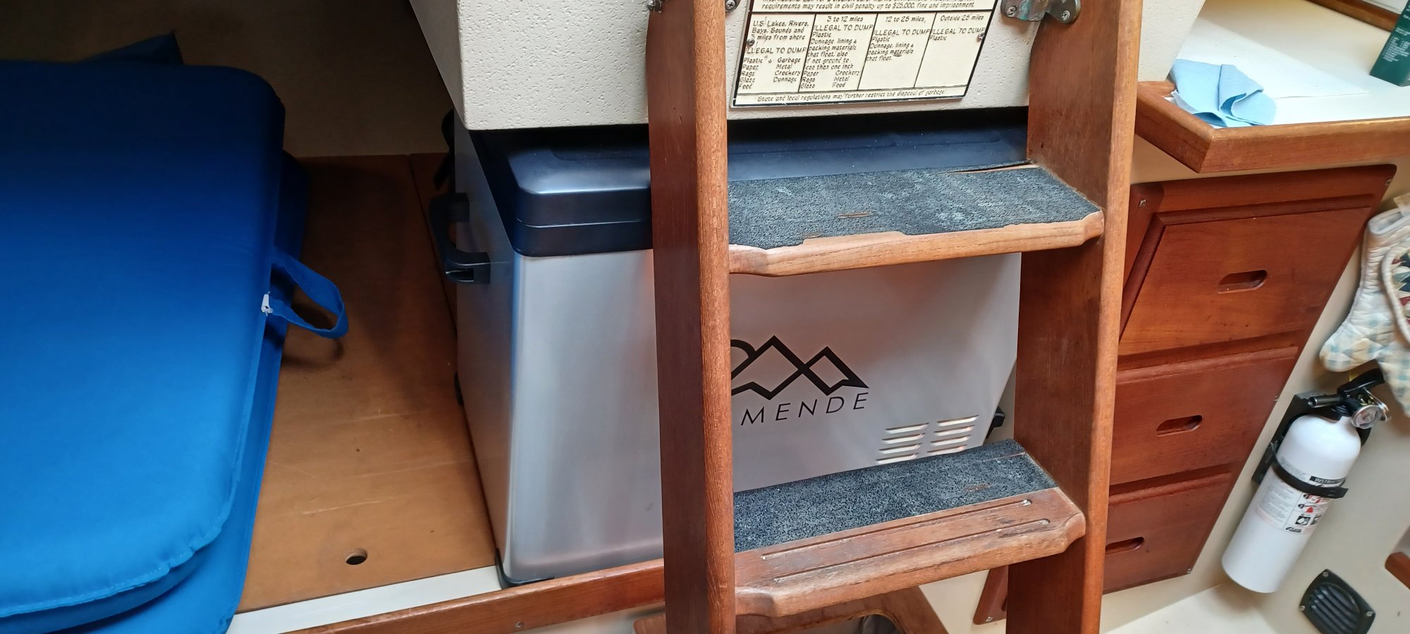

Another option is to get one of the many portable refrigerators around. Engle and Dometic are the big names but there are several others. Prices range from $200 to nearly $1,000 for an Engle or Dometic. My 22 liter one uses about 25 AH a day and holds enough food for up to a week.
Apr 5, 2009
3,327
I did this to add a freezer to my boat. I got this unit which is 50 liters and can be set to 65ºF to -4ºF for under $300.

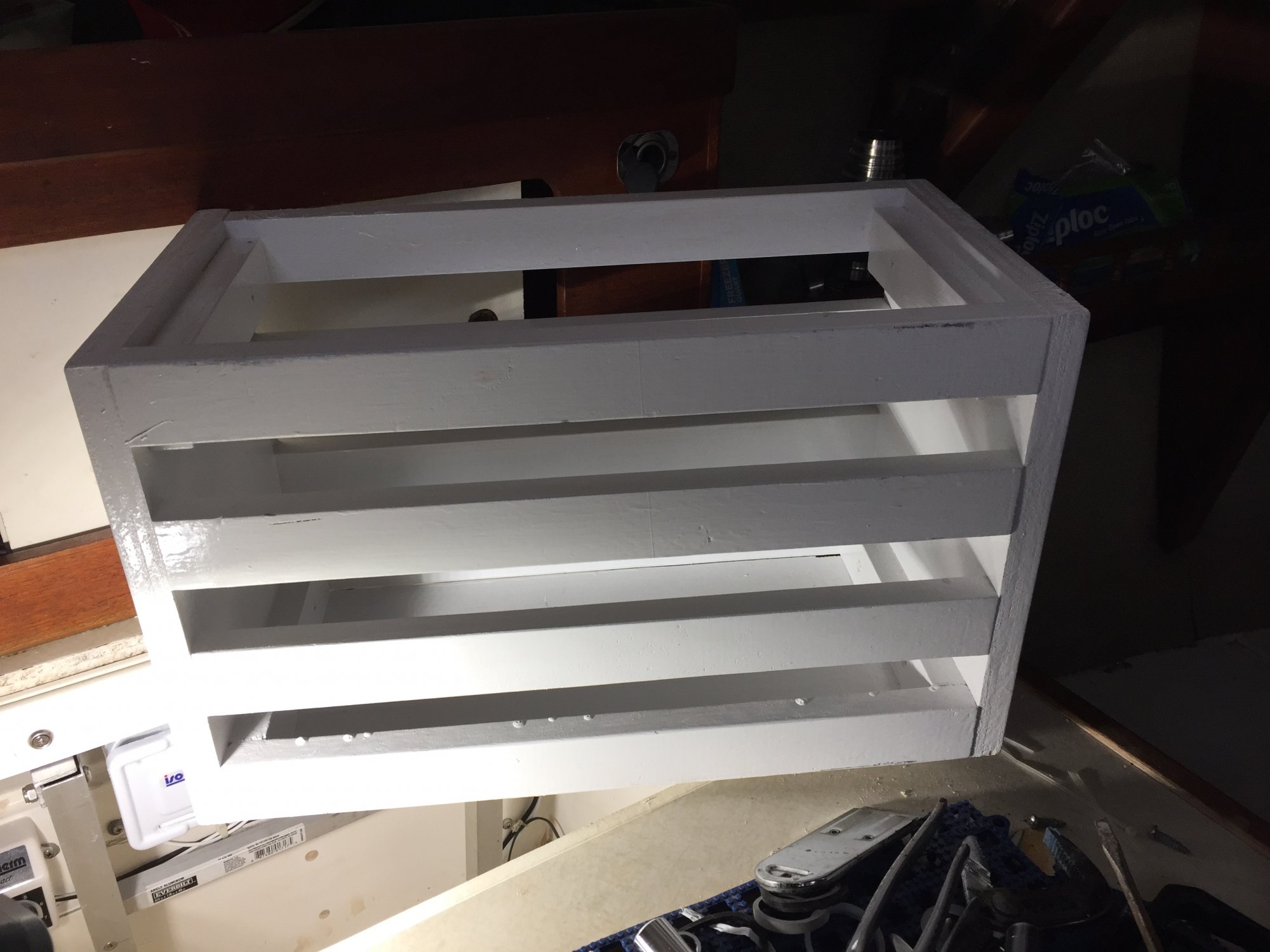

Most original ice boxes are deep to accommodate ice on the bottom. When you convert you will discover that food and beverages on the bottom are difficult to access. I made two stacking crates that solve this problem but you have to lift out the top one to get to the bottom one. Be sure to note Don's comments above about increasing battery and charging capacity.
