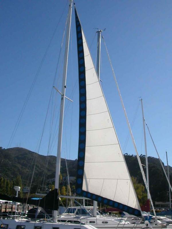

Here are pics of a couple of modified tools that make the process easier. The stapler is used to re-attach the tape to the sail so its firmly in position for sewing. It's a zero cost alternative to double-side basting tape. Raising the "bender plate" of the stapler is necessary so that the staples will bend normally since the thickness of the luff tape cord would otherwise prevent that. (Of course remove the staples after sewing ... they will rust and stain the sail if left in place.) Sharpening the knife in the manner shown greatly speeds up cutting the threads of the tape for removal from the old sail.
As evidence this can be done, the picture of the sail attached is result of the described process. Luff is 44'. I've been using it on San Francisco Bay for a couple of years now.
