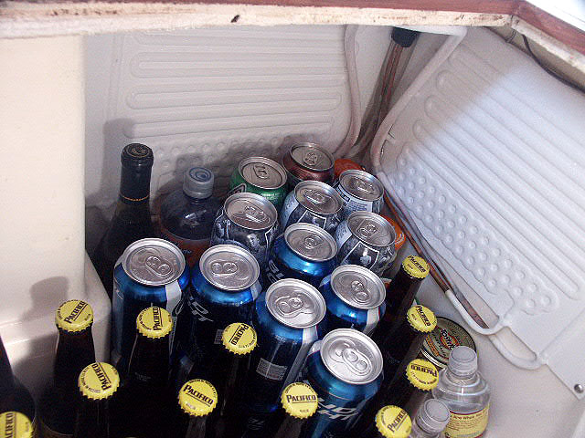

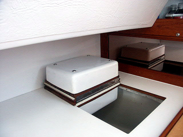

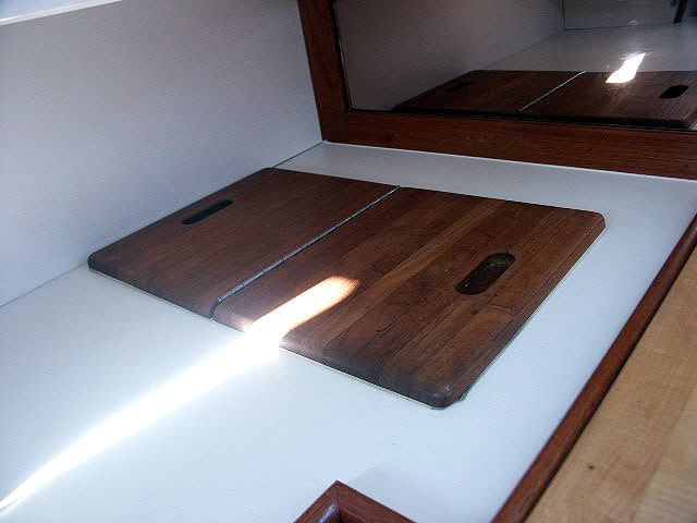

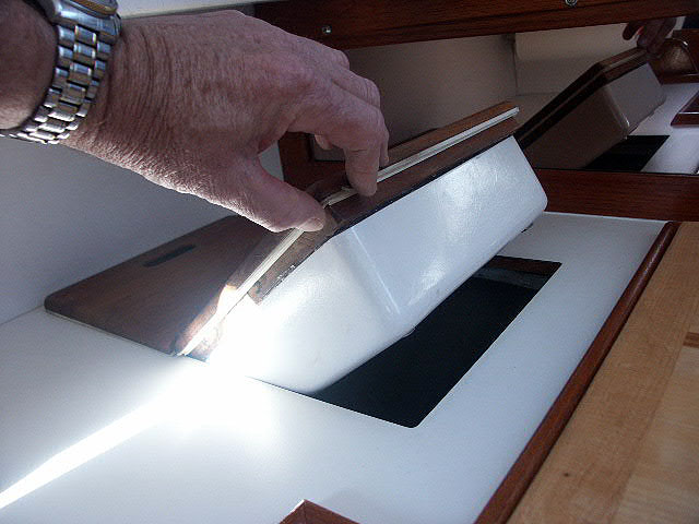

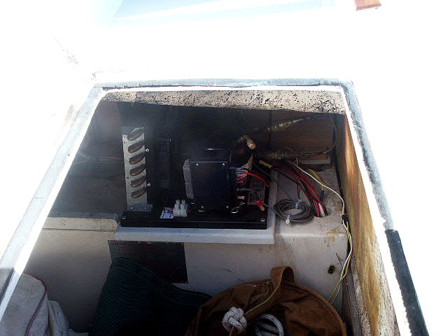

I converted mine about 3 years ago and have never regretted it. My choice was the NovaKool. I went without the freezer compartment due to the space it requires. The compressor sits on the ledge formed by the top of the ice box in the port seat locker. I gasketed and insulated the hinged ice box lid and put a stopper in the drain.
I installed it myself, really no big deal. It has an automatic low power shutoff to save the compressor in the event of low battery condition.
The Catalina factory ice box insulation is poor at best causing mine to run at about a 50% duty cycle in the summer. I find I can reduce that by backing the boat into the slip exposing the starboard side to the sun. Maybe someday I'll get aggressive with additional insulation but for now, I'll just enjoy the cold beer.

Neil, as you likely already know, there are multiple problems with the ice box. The exhaust hose runs just outboard of it as well (where of course you cannot effectively get any real additional insulation). I found my boat had insulation 'added'...some cardboard taped to the inboard and aft side, and a bunch of spray foam sprayed in there..I also had a lot of misc. chunks of cooler foam and soft foam jammed up all over the place when I replaced my exhaust hose...maybe some day I'll get aggressive with an access port of some type to get behind the icebox and insulate better. I was thinking maybe the port side liner to the stove there..some kind of hinged door or something? Is the ice box secured to that on the back side? :confused:
Interesting you put your compressor up there on the shelf in the sail locker..any reason for doing that instead of under/behind the cabinet in the galley (say, in between the drawers & the inboard side of the ice box??) That is where I naturally expected one to go, although I've never inspected another C-30 with refrigeration.

The shelf seemed logical to me so that's where I put it. The refrigerant line set has to get from inside the box to the compressor outside and one single 2" hole in the ice box top was all I needed. I hadn't thought about this at the time but consider that the compressor produces heat too so the higher it's mounted the better as heat flows upward. Sub Zero refrigerators mount their machinery at the top of the appliance for this reason. The shelf also provides excellent access.
FastBreak,
$1K for the NovaKool picked up at the supplier (no shipping). The NovaKool was recommended over an Adler Barbour by a marine refrigeration professional for reasons I can't remember. I figured he knew more than me so why not? Both use the same Danfoss compressor. The NovaKool system had a variety of cold plate configurations available. I chose a 2 plate system that mounts 1/2" off the aft and inboard ice box walls on provided spacers, takes virtually no box space. Except for the power supply wire, the kit came complete, nothing else to supply.
Following the old rule of thumb regarding refrigeration, I added a battery with the installation. Will do the same when I install my windlass.

Mine also is mounted almost exactly as Neil's. I'm able to vent any heat more readily and easily out of the lazarette vs. the main cabin. It's an alder barbour, installed when I bought the boat. Running the refer on a 210 amp/hr house bank. Happy with the accessibility of everything.

The system looks nice and it looks nicely installed.
I have heard that Catalina designed that shelf area in the lazzerette for putting the refrigeration system. I like the idea of cold plate system. I will probably never add refrigeration because of cost and the amount of battery power needed. I have two group 27 batteries for house batteries and I have a starting battery under the quarter berth.
