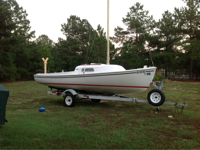

Matt,
I too had a chance to buy an early model mariner 2+2. Got lucky and found out that a newer model was also for sale in the same town. I arranged to see both before making the purchase. I really wanted the 1970, but when I saw the 1972 on up model design, I went with my 1973, which is the round top current design used by Stuart Marine.
I also searched for any posts on wood core rotting, and DID find that the older model's fiberglass is thicker than the '72+ models. There is wood in both arches and down the center of the cockpit roof on the old model, as you can see from Nathan's excellent website.
The 72+ glass has also no balsa core, and even though it is 40 years old, the glass has very few stress cracks on my boat. It does seem thin at first (compared to my '73 Southcoast, which did have a wood core, which showed signs of delamination), but is very sturdy. The pre 72 model's glass overall seemed thicker.
I went with the newer model as it had received new undercoating and the centerboard had been refinished as well. I do like the older models classic look, but my boat got me on the water within 3 weeks and my kids really enjoy it. (I had to do glass work, finish wood, and install new stays and rub rail, ordered from Rudy at D&R Marine, he is awesome!).
