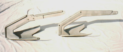

I have a 60# Manson Supreme with 350' of chain for my 410. If I had a 460 I would looking at a modern anchor (Manson Supreme, Rocna, Mantus) a size bigger at around 80# for a general everyday use anchor. But if I were in a location than was mainly soft mud I would be looking at a Danforth/Fortess type anchor.

Mantus or Rocna in that order or a used Bulwagga. Nothing else is worth it's weight for a primary anchor.

That is true with the old style anchors, but the Mantus, Rocna and Bulwagga work better than all the others in every bottom type. I primary have been using my Bulwagga for 50+ anchorages and it always sets where it is dropped, even in hard bottoms or grassy bottoms where others just minutes before me with their old style anchors failed. I love being able to anchor where others can't. The Mantus is the best anchor you can buy now so if you are looking for a new anchor, go with a Mantus.
