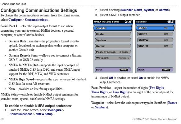

RPWillia You have a mistake in your diagram. The 540,270 and many other garmin plotters use the Blue wire as NMEA 1 out and in the case of the 540 the grey for NMEA 2 out. The brown wire is used for NMEA 1 input. Attached is the relevant page from the Garmin 540 manual. You will also need to configure the communications for serial port one to output NMEA as shown in the second image. Therefore it is the blue wire which should be wired to the NMEA + on the ST6002.

Not sure about your Garmin, but my Garmin 172 map has to be told in the setup to give out NMEA signals, that can also be the case for your unit.
