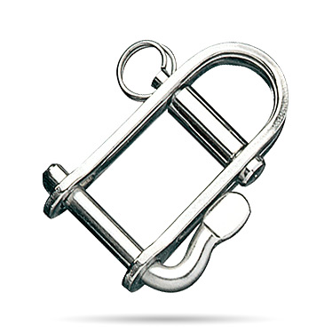

Halyard hitch will do the job.
Do your self a favor and go for proper halyard shackles.
I can't understand why you would use anything else.

Hi Dave.
Oh dear. Will this become an "anchor thread?"
I can think of reasons for many different attachments and use each if them, each where it is the best fit. For example, if cover wear is a problem anywhere (jammer or mast top), a knot makes it easy to shift the wear point every 6 months. If you are knotting rather than splicing, why bother with the shackle (unless you hace some frequent reason to remove the halyard)? A knot also allows for a higher hoist in some cases, if the sheeves are too small to pass the splice bulge. A halyard shackle is better if you have a reason to remove the halyard frequently or if the headboard or furler attachment is sharp, but a snap shackle is nice for reaching headsails, and a spliced-in soft shackle can save grams.
Horses for courses.
