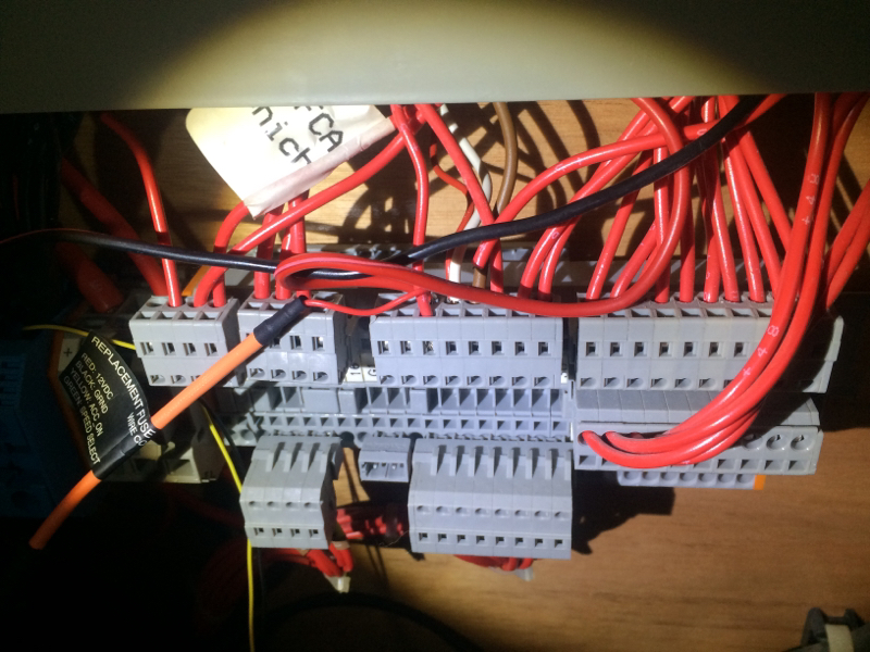

Look up WAGO Blocks either in your Beneteau manual, or google it. They are basically a push in connector. Strip the wire about 3/8", use a narrow screwdriver or a probe to push in on the side tab and essentially plug in the wire. Reverse the process to disconnect. It really fairly straightforward, Probably easier to do than to explain.
Nov 24, 2012
586
The difficult part is identifying the correct slot to insert wire. The last device I connected was to the specific breaker vs wego panel.
Oct 2, 2010
127
Beneteau 36 cc Humlebæk
Thanx a lot for your answers. I installed the wire in the slot this morning :)
Oct 29, 2006
388
Beneteau 381 Olympia, WA
Depending what you wire where and to what, you might have to put a fuse in the wire from the panel your AIS. there is a breaker in the front but it is probably far too high amp for your device. I individually fused any wire from the bus to device, one time I shorted something and it destroyed my GPS antenna, but the breaker did not trip...
